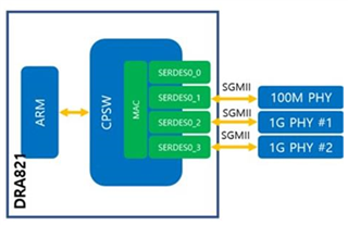

Three PHYs were connected through SGMII as below.
Test Conditions :
1. All the SGMIIs are connected to the Capacitor 100nF.
2. All PHY inputs and outputs consists of CML circuit.
3. SDK version : PSDK v8.1
4. Traffic load uses Spirit C1 equitment.

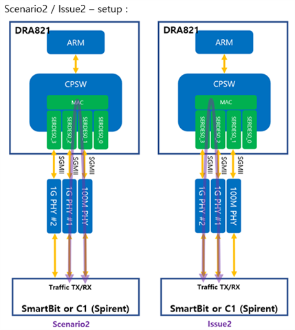

Issues 1. (100Base-T1 related)
Scenario #1
- Path : A72 -  CPSW - PHY - PC
- Problem : During the two-way test of ping between ARM and PC, the path of 100M PHY is packet loss. However No packet loss when using other 1G PHYs.
Scenario #2
- Path : 1G PHY #1 - CPSW - 100M PHY
- Problem : Packet loss occurs when transmitting and receiving 100Mbps of traffic.
- Remark : Only occurs in the 1G PHY -> 100M PHY direction
Attachments :
- after AP_CAP  : DRA821 output waveform
- after PHY_CAP : DRA821 input waveform
Issues 2. (1000Base-T1 related)
- Path : 1G PHY #1 - CPSW - 1G PHY #2
- Problem : When Full traffic load of 1Gbps, Packet loss occurs only at CPSW output terminal even though CPSW input terminal does not have packet loss.
Common Info :  Line loopback test of all PHYs confirmed no problem.
They believed the above issues appear to be related to the SGMII interface and CPSW
According to them, the strange thing is that if you test the speed at 999Mbps instead of 1Gbps, there will be no issue.
Please help and review as soon as possible.

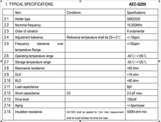

  • Hi TI
    There're some update from Customer experiments on this thread.
    1. Packet Loss disappeared when changed OSC0 19.2MHz with +-3ppm tolerenace part.
    They observed the packet loss problem has not been reproducible when 1G to 1G use case with packet size 64byte for 5 hours after changed OSC0 19.2MHz clock with very small frequency tolerance range within +/-3ppm which can not be applicable to their mass production due to delivery issue.
    The issue comes out when using +-50ppm tolerance with the specification below. it's from chinese supplier.
    They believe that even though the packet loss does not occur under the current conditions, production is not possible.
    They would like to ask you to check additional parts that you can try while showing this pattern.

  • Hi Ti
    There's a request on this issue.
    Customer has identified the issue(1Gbps-To-1Gbps) could not be reproducible when they applied 25.000625MHz with +PPM specification.
    However it's difficult to use +PPM part for their mass product due to supply issue.
    To avoid the packet loss issue, Please give TI' recommendation from Jacinto design team or official headquarter on this.

  • Hi TI
    Here's organized summary regarding their test case as below figure.
    Except 1G to 1G test case, there're still the packet loss issue and FCS error are observed as above when a sgmii port is configured for 100Mbps.
    Thanks.
    Jack
