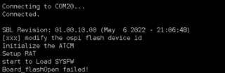

  • Hi, Parth
    In my custom board, boot from ospi flash fail, mcu uart log indicate that Board_flashOpen failed!:
    BR.
    Sancho

    MT35XL01GABA1G12 datasheet show the manufacture id is 0x2C, and the device id is 0x5B1B.
    MT35XL01GABA1G12 device id
    the MCU uart log output is:
    mcu log output
    BR.
    Sancho

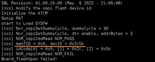

  • Hi, Parth
    In Nor_ospiReadId() function, read the manufacture id is 0x00 and device id is 0x2C5B.
    Actually the manufacture id of the ospi flash is 0x2C and device id is 0x5B1B.
    This is my diff about nor_ospi.c file
    diff --git a/packages/ti/board/src/flash/nor/ospi/nor_ospi.c b/packages/ti/board/src/flash/nor/ospi/nor_ospi.c
    index 61c6469..e15a069 100755
    --- a/packages/ti/board/src/flash/nor/ospi/nor_ospi.c
    +++ b/packages/ti/board/src/flash/nor/ospi/nor_ospi.c
    @@ -35,6 +35,8 @@
     #include <ti/board/src/flash/nor/ospi/nor_ospi.h>
     #include <ti/drv/spi/soc/SPI_soc.h>
     #include <ti/csl/soc.h>
    +#include <ti/drv/uart/UART_stdio.h>^M
    +#include <ti/drv/uart/UART.h>^M
     #if defined (j7200_evm)
     /* SPI entry offset is at index 5 of SPI config array */
    @@ -118,8 +120,11 @@ static NOR_STATUS Nor_ospiReadId(SPI_Handle handle)
         retVal = NOR_ospiCmdRead(handle, &cmd, 1, idCode, NOR_RDID_NUM_BYTES);
         if (retVal == NOR_PASS)
    +        UART_printf("[xxx] NOR_ospiCmdRead NOR_PASS\n");^M
             manfID = (uint32_t)idCode[0];
             devID = ((uint32_t)idCode[1] << 8) | ((uint32_t)idCode[2]);
    +        UART_printf("[xxx] manfID = 0x%x, devID = 0x%x\n", manfID, devID);^M
    +        UART_printf("[xxx] idCode[0] = 0x%x, [1] = 0x%x, [2] = 0x%x\n", idCode[0], idCode[1], idCode[2]);^M
             if ((manfID == NOR_MANF_ID) && (devID == NOR_DEVICE_ID))
                 Nor_ospiInfo.manufacturerId = manfID;
    @@ -130,6 +135,7 @@ static NOR_STATUS Nor_ospiReadId(SPI_Handle handle)
                 retVal = NOR_FAIL;
    +    UART_printf("[xxx] NOR_ospiCmdRead NOR_FAIL\n");^M
         return (retVal);
    @@ -259,13 +265,16 @@ static NOR_STATUS Nor_ospiSetDummyCycle(SPI_Handle handle, uint32_t dummyCycle)
         uint8_t                cmdWren = NOR_CMD_WREN;
         uint32_t               data[3];
         uint32_t               addrBytes;
    +    UART_printf("[xxx] Nor_ospiSetDummyCycle, dummyCycle = %d\n", dummyCycle);^M
         if (gDtrEnable == true)
    +        UART_printf("[xxx] Nor_ospiSetDummyCycle, dtr enable, addrBytes = 3\n");^M
             addrBytes = 3U;
         else
    +        UART_printf("[xxx] Nor_ospiSetDummyCycle, dtr disable, addrBytes = 2\n");^M
             addrBytes = 2U;
    BR.
    Sancho
