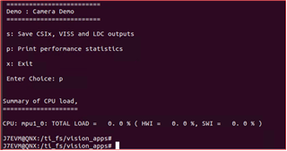

Yes, when we press 'p' on the console, it prints the performance numbers for all nodes in the graph, latency would almost equal to addition of average performance numbers of all nodes..

Please help us in getting correct response. I am seeing below response on running app_single_cam and app_multi_cam demo app. Please provide reference doc.
Hi Gautam,
Can you please share the full stats? If it is not printing, can you please try pressing 'p' few times? It should show CPU load, task load and individual node performance on the console.
