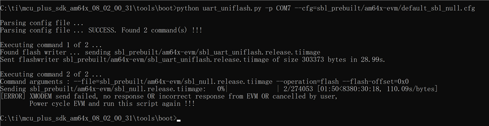

I just got an AM6442 starter kit SK-AM64. I am trying to follow the following links to flash SOC initialization binary.
1. https://software-dl.ti.com/mcu-plus-sdk/esd/AM64X/08_02_00_31/exports/docs/api_guide_am64x/EVM_SETUP_PAGE.html#EVM_FLASH_SOC_INIT
2. https://e2e.ti.com/support/processors-group/processors/f/processors-forum/1031069/sk-am64-how-can-i-get-ccs-to-connect-to-the-sk-am64-starter-kit
Now, I have set the UART boot mode and can see the character "C" getting printed on the UART terminal, according to link 1. However, when I run the python command, an error occurs as the following figure shown.

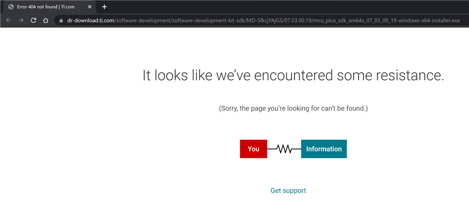

I found in link 2 that I need to use the NULL bootloader in MCU+ SDK 07.03.00.19, but what I installed is version: 08.02.00.31. However, when I plan to download and install the 07.03 version, I just find the download link is invalid now.
https://www.ti.com/tool/download/MCU-PLUS-SDK-AM64X/07.03.00.19
Therefore, may I ask how I can get this 07.03 version SDK? Or, is that possible to successfully flash SOC initialization binary to SK-AM64 with the 08.02 version SDK?
