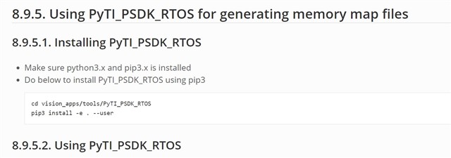

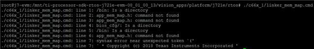

Hello TI.
I'm working on inferencing BlitzNet on TDA4 Board.
But I got a problem like this.
/opt ./vx_app_arm_remote.log
I checked the log about the Inferencing log under /opt/vx_app_arm_remote.log
Also, I found the similar Question in TI forum "Graph failed problem"
[reference link]
 https://e2e.ti.com/support/processors-group/processors/f/processors-forum/1084744/sk-tda4vm-tidl_rt_ovx-error-verifying-tidl-graph-failed

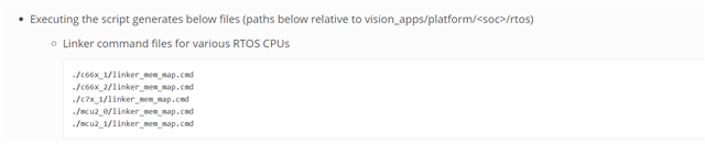

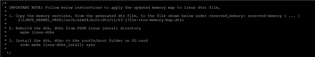

And I read that I should increase the memory size in DDR to accommodate these large requests. so I'm going to follow the next link
https://software-dl.ti.com/jacinto7/esd/processor-sdk-rtos-jacinto7/08_01_00_13/exports/docs/psdk_rtos/docs/user_guide/developer_notes_memory_map.html
You mean that I have to follow the code from that link right?
Board Environment : TDA4VM (ti-processor-sdk-rtos-j721e-evm-08_00_01_13)
Execution Path : /opt/tidl_test
ti-processor Path : /mnt/ti-processor-sdk-rtos-j721e-evm-08_00_01_13

    Yes, Please use the developer notes you have mentioned in the link and follow PyTI_PSDK_RTOS section to change/generate memory map...
    SDK has an example python script at vision_apps/platform/<soc>/rtos/gen_linker_mem_map.py
    This can be due to very huge model requiring more than the available DDR size on board / or allocated for C7x. Please increase the C7x DDR size and check if the issue persists.

  • gen_linker_mem_map.py
    I can read above script from gen_linker_mem_map.py.
    But there are no directory "${LINUX_KERNEL_PATH}/arch/arm64/boot/dtsti/ke-j721e-rtos-memory-map.dtsi"
    And I followed the documentation of increasing DDR size, I got an error during executing this.

  • I got an error when I executed above command "/c66x_1/linker_mem_map.cmd"
    directory : "/mnt/ti-processor-sdk-rtos-j721e-evm-08_00_01_13/vision_apps/platform/<soc>/rtos/ "
  • We have to do like the above picture, but We can't find the r5_mpu.xs location.

    Were you able to run "gen_linker_mem_map.py" ?
    You could increase the DDR size for C7x in this gen_linker_mem_map.py python script and once you build it, all the necessary files will be generated.
    Along with these files, there would be changes done to "k3-j721e-rtos-memory-map.dtsi" file too from the script.
    The same changes that were done by the script in this file k3-j721e-rtos-memory-map.dtsi should also be done manually in the Linux SDK 8.0 in the location Linux_SDK/board-support/linux-5.10.41+gitAUTOINC+4c2eade9f7-g4c2eade9f7/arch/arm64/boot/dts/ti/k3-j721e-rtos-memory-map.dtsi inside the reserved section.
    After this go the Linux_SDK location in the terminal and do "make linux-dtbs".
    This would generate dtb files.
    Build vision_apps and copy the file system to the SD card using the script make linux_fs_install_sd.
    Also copy the k3-j721e-edgeai-apps.dtbo and k3-j721e-vision-apps.dtbo from Linux_SDK/board-support/linux-5.10.41+gitAUTOINC+4c2eade9f7-g4c2eade9f7/arch/arm64/boot/dts/ti to the SD card rootfs/boot/ location.
