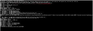

Cannot run Demo Applications in edge AI folder . Getting following errors
using following command-
root@j7-evm:/opt/edge_ai_apps/apps_python# ./app_edgeai.py ../configs/image_classification.yaml

Hi Saurabh,
Have you been able to run this setup script successfully: https://software-dl.ti.com/jacinto7/esd/processor-sdk-linux-sk-tda4vm/08_02_00/exports/docs/getting_started.html#installing-dependencies
[ERROR] no element "tiovxdlcolorconvert" indicates that some GStreamer plugins have not been set up successfully.
