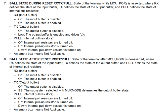

     Most AM64x IOs are configured to have their input buffers disabled, output drivers disabled, and internal pull-up/pull-down resistors disabled. This makes the system design easier to implement since we do not source any potential until software configures the IOs.
    There are a few exceptions and the customer can confirm the default states of each IO connected to their external devices by reviewing information provided in the Ball State During Reset and Ball State After Reset columns of the Pin Attributes table, where the following descriptions apply.  They may also need to consider the impact of AM64x IOs the ROM code attempts to use once reset is released.  The TRM has a section that defines which IOs are used by each boot mode selected.
    Please refer to the datasheet and TRM for more details on the IOs.

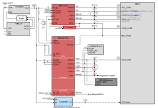

    Their design is following the Application note like below block diagram, but the peripheral devices are 1.8V powered by DCDC3 drawn as red circles in the following diagram. Therefore, LDO 1.8V IO (VDDSHVy) circled as blue is powered up earlier than 1.8V power rail from DCDC3 circled in red.
    They're concerned if AM64x IO sources a potential to the external devices which not yet powered by DCDC3.
    They think that there is no problem in this system because the architecture is the almost same as that in Application note. Are they correct ?
    If customer can take care of the IO selection and configuration, this should not be a concern.
    Can you please  share the app note link.
    Sreenivasa
