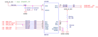

My main question is "How to set up gpio interrupt for SMI130?"
https://github.com/boschmemssolutions/SMI130-Sensor-API
(1) Here is our schematic,
SCx --> TDA4 SPI3_CLK (Y25, PRG0_PRU1_GPO17)
SDx --> TDA4 SPI3_D1_SOUT (AA29, PRG0_PRU1_GPO19)
SDO1/SDO2 --> SPI3_D0_SIN (AA26, PRG0_PRU1_GPO18)
CSB1 --> SPI3_CS0 (AA24, PRG0_PRU1_GPO7)
CSB2 --> SPI3_CS1 (AB26, PRG0_PRU1_GPO9)
INT1 --> GYRO-INT (G25, WKUP_GPIO0_4)
INT2 --> GYRO-ACC-INT (G24, WKUP_GPIO0_5)

    base on hardware design for TDA4,  modify device tree as below :
    * gpio interrupt input pinmux
    	mywkup_smi130_gpio_pins_default: mywkup-smi130-gpio-pins-default{
    		pinctrl-single,pins = <
    			J721E_WKUP_IOPAD(0xc0, PIN_INPUT, 7) /* (G25) WKUP_GPIO0_4 */
    			J721E_WKUP_IOPAD(0xc4, PIN_INPUT, 7) /* (G24) WKUP_GPIO0_5 */
    *  SPI3 pinmux
    	main_spi3_pins_default: main_spi3_pins_default {
    			J721E_IOPAD(0x144, PIN_OUTPUT, 4) /* (Y25) PRG0_PRU1_GPO17.SPI3_CLK */
    			J721E_IOPAD(0x148, PIN_INPUT, 4) /* (AA26) PRG0_PRU1_GPO18.SPI3_D0 */
    			J721E_IOPAD(0x14c, PIN_OUTPUT, 4) /* (AA29) PRG0_PRU1_GPO19.SPI3_D1 */
    			J721E_IOPAD(0x11c, PIN_OUTPUT, 4) /* (AA24) PRG0_PRU1_GPO7.SPI3_CS0 */
    			J721E_IOPAD(0xd4, PIN_OUTPUT, 4) /* (AB26) PRG0_PRU0_GPO9.SPI3_CS1 */
    * Compare to Bosch GitHub sample code, I add smi130 device node under SPI3
    &main_spi3 {
       pinctrl-names = "default";
       pinctrl-0 = <&main_spi3_pins_default &mywkup_smi130_gpio_pins_default>;
       status="okay";
       smi130_acc@0 {
       status="okay";
       spi-max-frequency = <500000>;
       reg = <0>;
       compatible = "smi130_acc";
       interrupt-parent = <&wkup_gpio0>;
       interrupts = <?? IRQ_TYPE_LEVEL_HIGH>;
       smi130_acc,gpio_irq = <&wkup_gpio0 ?? IRQ_TYPE_LEVEL_HIGH>;
       #address-cells = <2>;
       smi130_gyro@1 {
       status="okay";
       reg = <1>;
       compatible = "smi130_gyro";
       smi130_gyro,gpio_irq = <&wkup_gpio0 ?? IRQ_TYPE_LEVEL_HIGH>;
    1. Is this correct device tree stuff for SMI130?
    2. How do I fill in the interrupt number ?? (as question mark ??)
    Thanks very much for your comment.

  • Hi GIbbs,
    There is app note that you can refer for SPI validation. Please look at the pinmux changes: https://www.ti.com/lit/pdf/sprad26?keyMatch=DRA821
    It should be the number of GPIO in the wkup GPIO domain. As per your DT description it should be 4 & 5?
