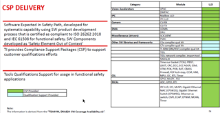

2. In TI Safety training document; we found CSP is supported/provided for all the below listed modules which are developed as SEOoC.
may I get the access for CSP content and CSP link?

    The slide shown above appears out of date, recommend reaching out to you local TI contact for latest TI S/W Roadmap.
