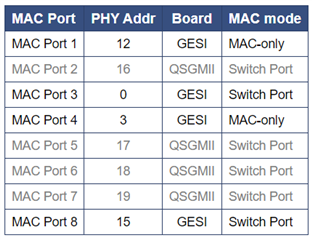

    According to ethfw user guide, For TDA4VM, the Multiple independent MAC interfaces are enabled by default for two of the ports as shown in the image :
    The Phy addressed 3 and 12 will act in the MAC-only mode.

    The MAC-Only feature is used to make a point to point connection between a MAC_PORT and a Virtual MAC port on host side. The traffic incoming to port4 in your case cannot be redirected to any other port other than the ethmac_device on mpu1_0. So every MAC-Only port will require its own interface client on the host side.
    In contrast to this, for a switch port, the incoming traffic on that port can be forwarded to any one or more ports connected to the switch. Only one interface client suffices for multiple ports on one host.
    If you see in the above image, MAC Port 1 and MAC Port 4 are routed directly through host port to there respective host. They are the MAC-Only mode ports. Rest go through a switch in which every port can have connection to every other port connected to that switch. They are switch-mode ports.
