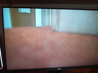

I have followed the instruction contained in the Edge AI Academy (Part7: Connect your own industrial camera) and I was able to connect one generic industrial camera to the SK-TDA4VM and run the app_edgeai demos as shown in the following image.

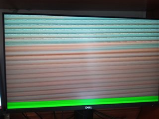

Unfortunately, when I configure the flow in the yaml file in order to have two models running on the same image I got the following results.
The same yaml config file is working if I pick another type of image source (see next image).

Any suggestion about the cause that impact the input image if I change the flow with multiple models?

  • Hello Shyam, thanks for your quick feedback.
    I agree with you it seems like the camera resolutions do not match.
    I have tried to double check it and I confirm that the resolution is set properly: the camera is streaming at 1440x928 in both cases (single model and multpiple model running).
    Here you can find the yaml file I am using.

    Basically it works when I put "input1" (instead of "input3") as a flow0 input or when I keep input3 and I put just one model and one output in the flow0 models and outputs array.
    It seems like the image got corrupted after the "tee" Gstreamer operation.
    Do you know why we can have such behaviour?

  • Hello Rahul, sure.
    I have just tried and it works.

  • This is replicating the issue I see in the demo.
    You can see the result in this picture.

  • This last pipeline have not reproduced the issue, the video is good.

  • Now it is corrupted again.
  • Hi Ugo,
    adding tee element before tiovxmultiscaler, is causing the issue
    I will get back to you on this issue
