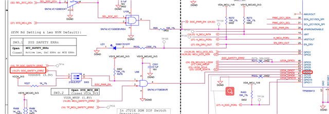

    Our board is j721e-evm and sdk is 8.0 prebuilt。
    SW2: 1-off, 2-on
    SW3: 1-on, 2-off

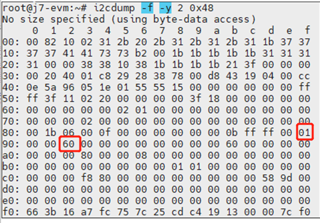

We are using the watchdog0. When the timeout occurs, we detected low-level output from SOC_SAFETY_ERRORn and low-level output from PIN 4 of U98 to GPIO7 of PMIC, but the system did not restart.
We checked the PMIC ESM_MCU_EN register configuration and it seems to be correct.
Is there anything else I should pay attention to?
