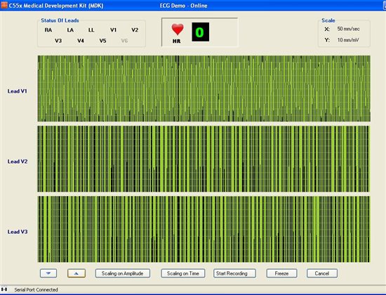

    i didnt find "ECGSystem.pjt" but instead "ecgsystem-nonbios.pjt' was available in Cds folder. i used it. it ask for "stdio.h" in CCS. i gave the file from CCS bin folder(it was not provided within the Cds). then i used .out file again from its CDs folder. the device lcd as well as pc application give output but too much noise. specially from v1 to v6. i tried to use ezdsp5505 .out and pjt files available from code.google as adviced me by ti employee named SEB. but then nothing happens all things become blank. i watched a demo video from ti site in which the operator use simulator for ECG. there i noticed change in jumpers comnfiguration for both AFE and EVM.

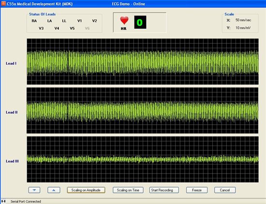

    You are following the right steps. One thing to be sure, when you stated the outputs on lcd and pc application are too noise, can you explain? What do you mean by noise?Maybe posting a screen dump capture? I suspect your HW is working fine. Let's be sure.

                 i am posting the screen shots. as you can see there is too much noise from v1 to v6 where as others have less noise. although i have just connected just one lead(v6) to a body. and v6 also shows the same pattern as v1 to v3. i suspect the AFE has a problem...??

    as for now the noise is gone to some extent...this time i used all the connections. but a new thing has manifested... heart is varying from 120 to 88, although i am lying perfectly still.
