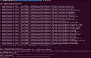

After that, I tried to build follow by https://software-dl.ti.com/jacinto7/esd/processor-sdk-rtos-jacinto7/06_02_00_21/exports/docs/tidl_j7_01_01_00_10/ti_dl/docs/user_guide_html/md_tidl_build_instruction.html.
$ cd ${TIDL_INSTALL_PATH}
$ make TARGET_PLATFORM=PC
But there is an error like below.

======== MAKING IMPORT LIBS =================
make -C ./ti_dl/utils/tidlModelImport -f makefile_shared
make[1]: Entering directory '/home/mobis/ti-processor-sdk-rtos-j721e-evm-07_01_00_11/tidl_j7_01_03_00_11/ti_dl/utils/tidlModelImport'
/usr/bin/ld: /home/mobis/ti-processor-sdk-rtos-j721e-evm-07_01_00_11/protobuf-3.5.1/src/.libs/libprotobuf.a(arena.o): relocation R_X86_64_TPOFF32 against symbol `_ZN6google8protobuf8internal9ArenaImpl13thread_cache_E' can not be used when making a shared object; recompile with -fPIC
/usr/bin/ld: /home/mobis/ti-processor-sdk-rtos-j721e-evm-07_01_00_11/protobuf-3.5.1/src/.libs/libprotobuf.a(descriptor.o): relocation R_X86_64_PC32 against symbol `_ZTVN6google8protobuf8internal16FunctionClosure0E' can not be used when making a shared object; recompile with -fPIC
/usr/bin/ld: final link failed: Bad value
collect2: error: ld returned 1 exit status
/home/mobis/ti-processor-sdk-rtos-j721e-evm-07_01_00_11/tidl_j7_01_03_00_11/makerules/rules.mk:696: recipe for target 'sharedlibfile' failed
make[1]: *** [sharedlibfile] Error 1
make[1]: Leaving directory '/home/mobis/ti-processor-sdk-rtos-j721e-evm-07_01_00_11/tidl_j7_01_03_00_11/ti_dl/utils/tidlModelImport'
makefile:255: recipe for target 'it_lib' failed
make: *** [it_lib] Error 2
How can I fix it to successfully build it?
Please help. Thank you.
  • Since you are trying to build only the test application, you can try below
    make tidl TARGET_PLATFORM=PC
    This will not build, tidlModelImport
    The actual issue seems to be related to the build of "protobuf-3.5.1" dependecny. If you caan give try with below for rebuild of protobuff
    ./configure CXXFLAGS=-fPIC --enable-shared=no LDFLAGS="-static"

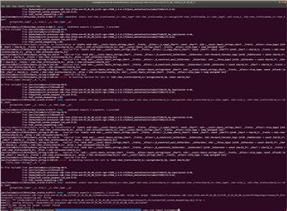

    Now there is another error.(below)
    In file included from /usr/include/c++/7/string:40:0,
    from /usr/include/c++/7/bitset:47,
    from /home/mobis/ti-processor-sdk-rtos-j721e-evm-07_01_00_11/ti-cgt-c7000_1.4.0.LTS/host_emulation/include/C7100/ti_he_impl/vector.h:40,
    from /home/mobis/ti-processor-sdk-rtos-j721e-evm-07_01_00_11/ti-cgt-c7000_1.4.0.LTS/host_emulation/include/C7100/c7x.h:65,
    from tidsp/tidl_custom_maxpool_ixX_oxX.h:25,
    from tidl_custom_maxpooling.c:82:
    /usr/include/c++/7/bits/char_traits.h:673:7: note: candidate: static std::char_traits<char32_t>::char_type* std::char_traits<char32_t>::assign(std::char_traits<char32_t>::char_type*, std::size_t, std::char_traits<char32_t>::char_type)
    assign(char_type* __s, size_t __n, char_type __a)
    /usr/include/c++/7/bits/char_traits.h:673:7: note: candidate expects 3 arguments, 2 provided
    /home/mobis/ti-processor-sdk-rtos-j721e-evm-07_01_00_11/tidl_j7_01_03_00_11/makerules/rules.mk:466: recipe for target '/home/mobis/ti-processor-sdk-rtos-j721e-evm-07_01_00_11/tidl_j7_01_03_00_11/out/PC/dsp/algo/release/ti_dl/custom/tidl_custom_maxpooling.obj' failed
    make[1]: *** [/home/mobis/ti-processor-sdk-rtos-j721e-evm-07_01_00_11/tidl_j7_01_03_00_11/out/PC/dsp/algo/release/ti_dl/custom/tidl_custom_maxpooling.obj] Error 1
    make[1]: Leaving directory '/home/mobis/ti-processor-sdk-rtos-j721e-evm-07_01_00_11/tidl_j7_01_03_00_11/ti_dl/custom'
    makefile:288: recipe for target 'custom' failed
    make: *** [custom] Error 2
    Do you have any idea?

    modules/python3/CMakeFiles/opencv_python3.dir/build.make:160: recipe for target 'modules/python3/pyopencv_generated_include.h' failed
    make[2]: *** [modules/python3/pyopencv_generated_include.h] Error 255
    CMakeFiles/Makefile2:2772: recipe for target 'modules/python3/CMakeFiles/opencv_python3.dir/all' failed
    make[1]: *** [modules/python3/CMakeFiles/opencv_python3.dir/all] Error 2
    Makefile:162: recipe for target 'all' failed
    make: *** [all] Error 2
    And I couldn't solve the problem so I built opencv-3.2.0 successfully, and edit the ti-processor-sdk-rtos-j721e-evm-07_01_00_11/tidl_j7_01_03_00_11/makerules/config.mk 140 line like below.
    # Below are only needed for PC emulation Test bench build
    # TIDL_OPENCV_PATH ?="$(PSDK_INSTALL_PATH)/opencv-3.1.0"
    TIDL_OPENCV_PATH ?="$(PSDK_INSTALL_PATH)/opencv-3.2.0"
  • Do you have any idea?
