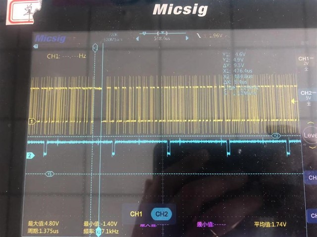

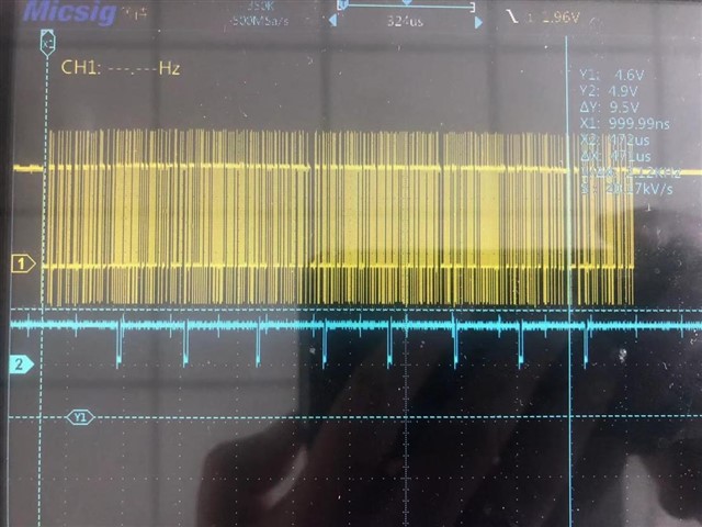

Hi experts
UART0 is used to realize the sending and receiving of serial data,
baud rate: 1.5MHz
start bit: 1
stop bit: 1
data: 8bits,
parity bit: 1.
The configuration code is as follows:

During the UART0 self-loop test (the transceiver line is directly short-circuited), if the data sent continuously is greater than 64 bytes, a crash will occur. In the test, every time 72 bytes are sent, there must be a crash.
Debugging process:
1. Sender:
Do not use DMA, set the send interrupt trigger threshold to 32, and automatically transfer data to the FIFO after triggering the interrupt, each time no more than 32 bytes; until the buffer has no data; the buffer size is currently defined as 32768.
Debugging: no self-looping, there is no problem in sending 960 bytes continuously every 10 milliseconds, and there will be no crash phenomenon; the oscilloscope observes the data, and there is no problem. Basically eliminate the problem of the sender.
2. Receiver:
Do not use DMA, set the receive interrupt trigger threshold to 8, and directly read the data in the 8 FIFOs after each interrupt is triggered. At present, it seems that the receiving end causes
Debugging: As an interrupt problem was suspected, an output pin on the board was set as a test to indicate the process of receiving interrupt processing. Enter the receive interrupt, the pin is pulled low; the interrupt processing is completed, the pin is pulled high.
(1) Continuously receive data equal to 64 bytes:
It can be seen that the processing of the 8 receiving interrupts is basically in line with the design expectations. At this time, the ARM will not crash.
(2) Continuously receive data equal to 72 bytes:
You can see 8 interrupts on the oscilloscope; after the eighth interrupt, there is still data, and there should be 8 bytes to trigger another interrupt, but it has crashed at this time, and the ninth interrupt has not come.
(3) Continuously receive data equal to 128 bytes:
15 interrupts can be seen on the oscilloscope; after the 15th interrupt, there is still data, and there should be 8 bytes to trigger another interrupt, but it has crashed at this time, and the 16th interrupt has not come.
(4) The compartment receives 2 consecutive 64-byte data:
Send two 64-byte data in a row, with a deliberate interval in between.
16 interrupts can be seen on the oscilloscope; reception is normal, no crashes.
The interval between two consecutive data is about 8us:
From what I have seen so far, it seems that the receiving end of UART0 cannot receive continuous data larger than 64 bytes; please help me to see if it is a setting problem?
