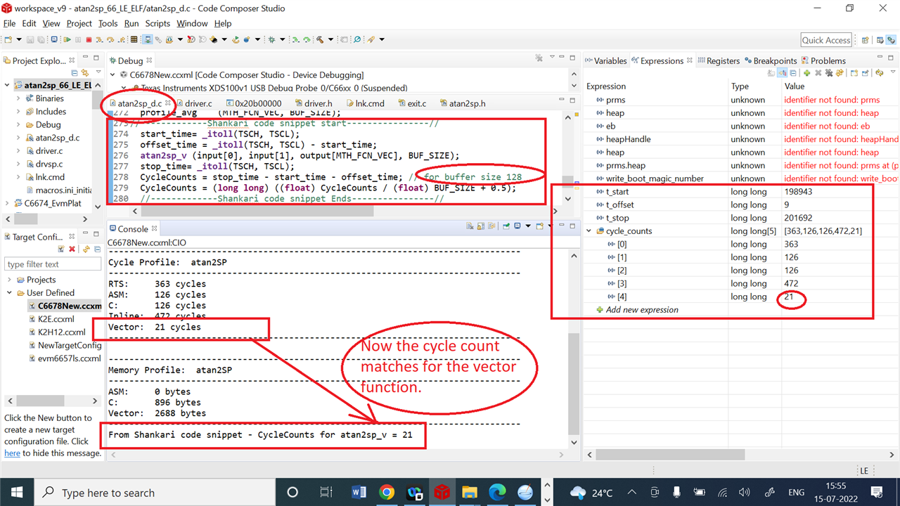

I am trying to get the time it takes for benchmarking DSP C66xx in CC9.3.
I have attached the screenshot from my simulation, it shows 21 cycles for vector cycles among other things... I am trying to get a confirmation of this comparing to that of DSP benchmarking document by TI (SPRAC13). Has anyone tried to do the benchmarking for Arctan2? Thanks.

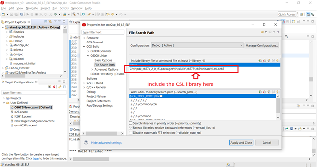

  • Hi Shankari,
    I tried building after integration of the code you provided, however I am getting a few errors that relate to "gmake" and "unresolved symbol remain"!
    Ali

  • Ali,
    Able to use the "TSCH" to calculate the cycles taken for the function, "atan2sp_v"
    Steps:
    In the file, atan2sp_d.c, do the following.
    Step 1:
    1. extern void  CSL_tscEnable(void); // This function is part of CSL library. We have to include  library, "ti.csl.ae66" located in the C:\ti\pdk_c667x_2_0_15\packages\ti\csl\lib\c6678\c66\release\ti.csl.ae66 in the project configuration. ( Look at the snapshot below )
    Step 2:
    2. Declare these variables.
    /*Throughput calculation initialization */
    unsigned int StartTime = 0;
    unsigned int EndTime = 0;
    unsigned int Total_cycle_ticks = 0;
    /*Throughput calculation initialization Ends */
    Step 3:
    3. Define the utilReadTime32() function.
    * Function: Utility function a cycle clock
    extern cregister volatile unsigned int TSCL;
    uint32_t utilReadTime32()
    uint32_t timeVal;
    timeVal = TSCL;
    return timeVal;
    Step 4:
    /* Enable the time stamp counter. */
    CSL_tscEnable();
    StartTime = utilReadTime32();
    atan2sp_v (a_sc, b_sc, output[MTH_FCN_VEC], NUM_SC_INPUTS*NUM_SC_INPUTS);
    EndTime = utilReadTime32();
    Total_cycle_ticks = EndTime-StartTime;
    printf("StartTime = %d \n", StartTime);
    printf("EndTime = %d \n", EndTime);
    printf("Total_cycle_ticks = %d \n", Total_cycle_ticks);

    snapshot to include the CSL library in the build configuration:

    I analysed bit more and could understand how they got 21 vector cycles and how we got 857 cycles.
    What we missed is this:
    The BUF_SIZE used in the atan2sp_v function is 128.
    They calculated the cycles of atan2sp_v with BUF_SIZE 1.
    They divided the total number of cycle count by 128 and got the result as 21 cycles.
    21 vector cycles is the code execution time for "atan2sp_v" function with BUF_SIZE = 1.
    ==> 2732 cycles for the code execution for "atan2sp_v" function with size 128 ---> i.e., BUF_SIZE = 128.
    2732 / 128 = 21.34 ====> 21 vector cycles.
    If we could do the step by step debugging, we could easily get these details.

    //-------------Shankari code snippet start----------------//
      start_time= _itoll(TSCH, TSCL);
      offset_time = _itoll(TSCH, TSCL) - start_time;
      atan2sp_v (input[0], input[1], output[MTH_FCN_VEC], BUF_SIZE);
      stop_time= _itoll(TSCH, TSCL);
      CycleCounts = stop_time - start_time - offset_time; // for buffer size 128
      CycleCounts = (long long) ((float) CycleCounts / (float) BUF_SIZE + 0.5);
      //-------------Shankari code snippet Ends----------------//

      printf("From Shankari code snippet - CycleCounts for atan2sp_v = %d \n", CycleCounts);

    Here you go.
    Step1 :
    Add the below code.
    long long start_time;
    long long stop_time;
    long long offset_time;
    long long CycleCounts;
    step2:
    Add this code after profile_Avg function of  "Time the fastRTS vector function"
    Step 3:
    Add below code after ----- print_memory_results (KERNEL_NAME);
  • Shankari,
    Looks good! Thank you for all your help Slight smile
