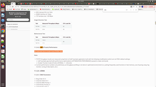

Here is the snapshot from the datasheet.
1.1.2.4.2. UDP (IP stack) Performance
1.1.2.4.2.1. CPSW9G - Main domain R5_0 core 0 (mcu2_0)
- Main domain R5_0 at 1GHz
- RGMII interface at 1Gbps
Single Direction Test
Test Measured Throughput (Mbps) CPU Load (%) UDP RX 168.0 93 1.1.2.4.2.2. CPSW2G - MCU domain R5 core 0 (mcu1_0)
- MCU domain R5_0 at 1GHz
Test Measured Throughput (Mbps) CPU Load (%) UDP RX 142.0 95 Note:
- TCP/IP throughput results are measured using Enet LLD lwIP example application built with the following modifications which are not PDK’s default settings:
- lwIP example app built with performance optimizations (OPTIMIZATION=PERFORMANCE passed to make command)
- Enable Thumb2 mode (CFLAGS_INTERNAL += -mthumb)
- Current performance numbers are preliminary as throughput profiling is not done in optimized environment (i.e. putting frequently used functions in fast memory, use of pacing using ring monitor, tuning of descriptors, etc.)
