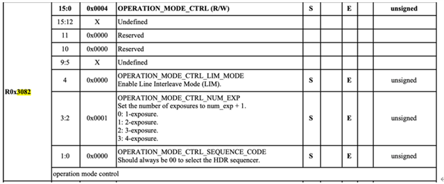

I am using TDA4VM SDK with AR0820 to capture images. image Sensor settings are the Default provided by your company.
(ti-processor-sdk-rtos-j721e-evm-08_00_00_12\imaging\sensor_drv\src\ar0820)
With that setting, when the color temperature is high in the daytime (over 10,000 lx), the current mode (Three shutter WD)
Q1 . I want to suppress the exposure. Is there any way to reduce the exposure?
