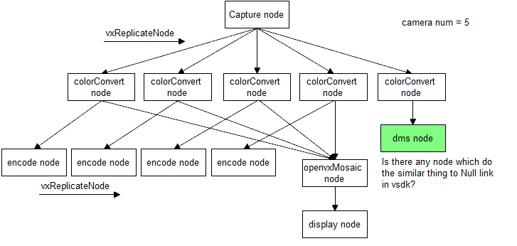

Hi team,
Is there any node in TIOVX execute the function as Null link in TDA2 VSDK? which could be used do something in A72?
In TDA2 VSDK, there is  Null link which could do some process at A15 core and by callback function when receiving the images from other link while there isn't any node could do the similar thing on TIOVX, so it's difficult to process the image from camera in A72.
The customer would like to know how to create new node to process image such as  Null link in VSDK? Or is there any other nodes in TIOVX could do the similar thing on TIOVX?

  • Hi Cherry,
    No there is no null node in TIOVX.
    Do you mean null-sink link? i dont recollect if null-sink was doing any processing..  It can just receive input some other link and return the input as it is back.. There is not any node like this in TIOVX, but you could have output of node unconnected or can declare it as graph parameter and can get this output in the application.
    The above graph could be realized by opening capture node two times, one for 4 channels and second for 1 channel. 4-channels can be for encode and mosaic and fifth channel for the dms path.

  • Hello Brijesh
    Nice to communicate with you.
    I'm the one post the question. and now this issue is fixed and closed by using a select node which created by PyTIOVX tools. But I'm not sure this is the best solution for this certain question.
    on the other side, it seems interesting to solve this question by opening capture node twice. could you kindly give the example code ? I wanna know how to implement this.
    Thanks and best rgds!
    have a good weekend.

  • Hello Brijesh,
    Thanks for your kindly help and response.
    For select node, the input is object array contrains image frames which comes from capture node or something else, the output the another object array consists of images. e.g. there are 5 camera, channel [0,1,2,3,4], every one produce image frames at certain rate. and the first four should send their output into encode node and the fifth one should send to process the image.
    then we could create two select node, both of them take the 5 cameras' output as input, and the first select node choose the first four channel frames and copy the frame to output object array. the second select node choose the fifth channel frame and copy it to output object array.
    this select node works as the select link in vision sdk (or processor sdk in tda2x).
