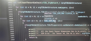

Hi Pramod,
Thanks for replying.
I have another question. When the model is imported for TIDL, this function will check the dimension of the input tensor, which needs to be greater than 0 in all four dimensions. If for one-dimensional input, does it need to be setted as 1 x 1 x 1 x N ?
In addition, does the Concat layer support splicing three one-dimensional inputs?
