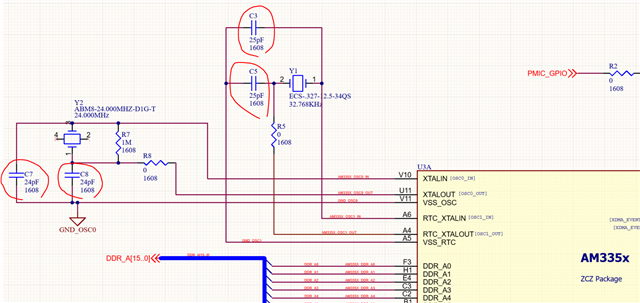

Hi experts.
I wonder how to choose load capacitance.
Please take a look at my schematic following.
I just copied the capacitance value from am335x reference board.
But I am not sure the value is ok.
Please give me comments

Hi GukHyun Lee,
Thanks for the query.
The capacitor value is chosen based on the Load capacitance(CL) spec of the crystal.
Capacitor values that you used looks fine, although you are using different crystals compared to EVM schematics.
