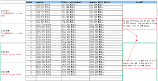

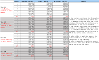

When i use J721S2 SDK. I find some fault.
The version is j721s2-evm-08_00_04_04 i used. when i test ddr write rate compare with J721-evm. i find the ddr write rate is very low.  It is only 1/20 of EVM board.
if i use cmalloc to get ddr, i find that the ddr write rate is more than EVM board. This is right. I hope if i use  tivxMemAlloc to test, the ddr write rate is also more than EVM board.
This is my test report.
because tivxMemAlloc is used in openvx, so we can use tivxMemAlloc  rather than cmalloc.
Meybe you can share me a patch to solve it.
we are urgently to use tivxMemAlloc function in J721S2 board.
