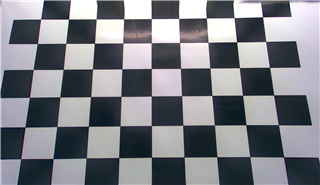

Is there any way to configure optical center such that distortion can be corrected around the optical center as we do it for LSC in DCC.
We need this because the center of the lens does not match the image center as shown in the shading profile below and this adds to the distortion after LGD correction. It would be helpful the mesh can be configured in a way to match the optical center.
Any help with regards to this is highly appreciated.

    With the change in optical center, mustache distortion is reduced but perspective distortion is introduced because of mesh center offset.
    Is there a way to correct perspective distortion? Could you please provide a guide on tuning affine transform coefficients?
    Kindly see the reference image that has perspective distortion introduced.

  • Hi Apeksha,
    You may add the perspective change into your mesh LUT as well or use the perspective transform if the change is very small.

    We applied perspective transform to the image and can see that the perspective distortion is eliminated.
    The same is applied to the mesh grid as below for mesh generation
        pts1 = np.float32([[335, 129], [2193, 121],
                            [165, 1300], [2360, 1300]])
        pts2 = np.float32([[165, 130], [2360, 130],
        pts1 = pts1 / (pow(2,m))
        pts2 = pts2 / (pow(2,m))
        matrix = cv2.getPerspectiveTransform(pts1, pts2)
        mh = cv2.warpPerspective(mh, matrix, mh.shape)
        mv = cv2.warpPerspective(mv, matrix, mv.shape)

    The mesh generated with and without the perspective transform correction has the same size
    Also, DCC does not generate any errors for generating simulated output with the mesh without perspective transform.
    Kindly let us know if there is any other way to correct the perspective transform.

  • You may try the semi-auto mode or reduce the output block size manually.
  • Hi Gang,
    Thank you for your inputs, yes, we tried reducing the output block size, but the simulated output is not as expected.
    It appears the perspective transform applied to the mesh LUT is not getting applied properly.
    Kindly let us know how to apply perspective transform to the mesh LUT generated.

  • Hi Apeksha,
    OK, you mean the new LUT does not give you the correct transform.
    This shall be fine if everything is done correctly.
    For example, if you need all your output image pixels to move to the right for 10 pixels, the H coordinates (for input pixels) shall be subtracted by 10 pixels.
    You will also need to use the correct integer encoding format for "mh, mv" pairs (they are differences and encoded in in an integer format).
    The FAQ has the information in matlab/octave code.
    You may implement a simple 10-pixel right-shift and a simple 10-degree clock-wise rotation first.
    Once you get both of those correct, you shall have the correct flow for inserting your warp.
