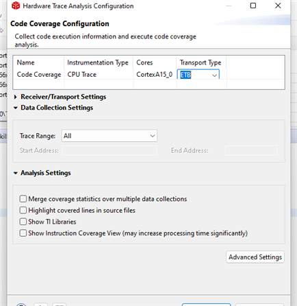

I am currently using Version: 10.4.0.00006. Whenever I used the Code Coverage Function, my IDE hangs.
Data Collection Settings Trace Range: All
Are there any settings that needs to be set for this to work?

    Which debug probe are you using? The onboard XDS100v2 or are you using an external debug probe?
  • Hi, I am using XDS100v2
  • When exactly does the hang first happen? I can reproduce the hang when I try to shut down the trace session. When do you see it?
  • I am able to start trace and collect trace/coverage data using the A15 ETB with CCS 10.4. Are you able to collect any data before the hang?
  • no I wasn't able to collect any data before the hang. are there any things that I need to do? based from the logs I sent, were you able to see the reason why mine is hanging? I also tried with an older version of Code Compose Studio 10 and it also hangs.

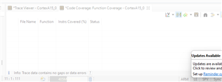

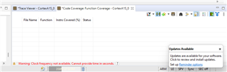

    Before I start the code coverage, it gives me a warning Clock Frequency not available. Cannot provide time in seconds.
    Once I run it, I can see that it stops on the next breakpoint, but the CCS program isn't responding, There will be an info on the Code Coverage View: Info: Trace data contains no gaps or data errors.
