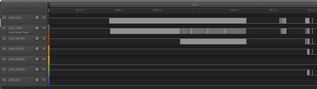

My AM3352 board fail to boot from SD card.
The hardware environment of the my AM3352 board is shown below.
1. MPU: AM3352BZCZ100
2. PMIC: TPS65218D0
3. DDR3L: MT41K256M16TW-107
4. eMMC: KLM8G1GETF-B041
( AM335x + TPS65218D0 hardware reference design referenced. ( TIDA-050xxx_BBB-refresh_RevE2.zip )
https://e2e.ti.com/support/power-management-group/power-management/f/power-management-forum/959994/tps65218d0-am335x-tps65218d0-hardware-reference-design?tisearch=e2e-sitesearch&keymatch=am335x%20tps65218d0 )
1) My SYSBOOT Configuraition
SYSBOOT[4:0] = 11000b (SPI0/MMC0/USB0/UART0)

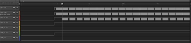

1) When booting without SD card inserted, "cccccccccc" is output from uart1.
2) When the SD card containing the boot image is inserted and booted, nothing is output from uart1.
(1) All Area ( CMD datum are repetitive )
(2) A different part from the normal board

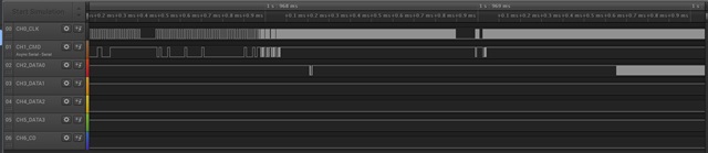

2) MYiR MYC-C3354-4E512D-80-I-GW board normally boots from SD card.
(1) All Area
(2) A normal part
The waveform captured by the logic analyzer is attached.
