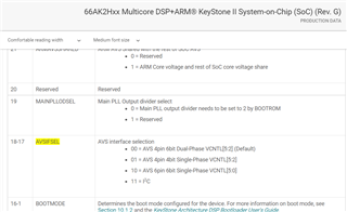

The 'BOOTCFG_' registers contain expected values, especially the 'BOOTCFG_DEVSTAT' corresponds to the strap pins, setting the boot mode and its parameters:
BOOTCFG_DEVSTAT = 0x00060395
It seems the processor is reset (the emulator probe was disconnected), I also verified the RESET pin of the NOR device is pulsed. When in such unstable state of the NOR access, I connected to the SoC the emulator back and invoked Board Setup (PLL setup, etc.) function in GEL from CCS, the Memory Browser momentarily shown valid data at the given address space, but then all was filled with the '0xFFFFFFFF' pattern.

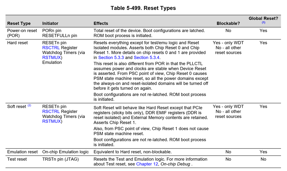

  • I think possibly the PLL that drives GPMC is getting reset isolated.  So when the boot ROM executes, the frequency is not as expected and the boot fails.  Especially considering the errata you cited, this PLL needs to be set correctly using the info from the BOOTCFG pins.  Can you ensure the PLL associated with GPMC is not reset isolated in the RSISO register?
    You are correct that the warm reset should not be re-latching the boot pins, so the original BOOTCFG_DEVSTAT should remain.
    James
    I read the RSISO register, there is 0x00000001 value before I triggered the warm reset, I expect the least significant bit is not related to the GPMC. I have also set the RSISO to zero, so no reset is isolated, the result is a bit worse, when I try to perform the Board Setup function in GEL, I will get 'Could not read register CP15_Registers.REG_CTXA15_CP15_C0_MPIDR: execution state prevented access at (REG_CTXA15_CP15_C0_MPIDR&0x3)' error. The POR is the only way how to get it running properly again. I also cleared the bit 'RESETISO' in MDCTL9 register, the situation is the same as if I do not change anything related to the reset isolation.
    I have found, according to section '5.3.3 Hard Reset' in TRM, the hard reset shall reset neither test nor emulation logic. An emulator session should continue unaffected. But, after the warm reset, I get 'CortexA15: Error: (Error -1170 @ 0x0) Unable to access the DAP. Reset the device, and retry the operation. If error persists, confirm configuration, power-cycle the board, and/or try more reliable JTAG settings (e.g. lower TCLK). (Emulation package 9.6.0.00172) ' error message, the emulator is disconnected, then I need to re-connect the emulator manually for debugging.
    I changed value in the DEVSTAT register before the RST is triggered, unfortunately, that custom value is overwritten (re-latched) back to the corresponding one from BOOTCFG pins after the reset.

  • Andy, the CONFIG1_0 register is different.  Can you try setting that register to 0x1010 before triggering the warm reset in software?  Then perform the same register dump to compare again.
    Regarfds,
    James
  • Hi James,
    When debugging the value is 0x1010 prior to setting rsctrl to perform the reset.  Setting that value again before setting rsctrl and running natively without the debugger has no affect.  The warm reset still fails.

    Register dump after issuing the reset:
    C66xx: GEL Output: PLL Registers
    C66xx: GEL Output: RSCTRL: 0x023100E8 0x00010003
    C66xx: GEL Output: GPMC Registers
    C66xx: GEL Output: REVISION: 0x21818000 0x00000060
    C66xx: GEL Output: SYSCONFIG: 0x21818010 0x00000000
    C66xx: GEL Output: SYSSTATUS: 0x21818014 0x00000001
    C66xx: GEL Output: IRQSTATUS: 0x21818018 0x00000000
    C66xx: GEL Output: IRQENABLE: 0x2181801C 0x00000000
    C66xx: GEL Output: TIMEOUT_CONTROL: 0x21818040 0x00001FF0
    C66xx: GEL Output: ERR_ADDRESS: 0x21818044 0x34000000
    C66xx: GEL Output: ERR_TYPE: 0x21818048 0x00000211
    C66xx: GEL Output: CONFIG: 0x21818050 0x00000A00
    C66xx: GEL Output: STATUS: 0x21818054 0x00000301
    C66xx: GEL Output: CONFIG1_0: 0x21818060 0x00001002
    C66xx: GEL Output: CONFIG2_0: 0x21818064 0x000A1200
    C66xx: GEL Output: CONFIG3_0: 0x21818068 0x22060514
    C66xx: GEL Output: CONFIG4_0: 0x2181806C 0x0A04721C
    C66xx: GEL Output: CONFIG5_0: 0x21818070 0x05110A14
    C66xx: GEL Output: CONFIG6_0: 0x21818074 0x8F070000
    C66xx: GEL Output: CONFIG7_0: 0x21818078 0x00000C70

  • Andy, so the error address in ERR_ADDRESS is showing 0x34000000.  Based on what you have setup in CONFIG7, your CS size is 64MB (ie, from 0x30000000-0x33FFFFFF).  Is this the size of your NOR flash?
    During boot, the device is attempting to access 0x34000000, but this would be in a different CS.  However, after a reset, only CS0 is enabled.  Is the access at this address expected?  Can you think of a reason this address would be accessed after a warm reset, but not after POR?
    James

  • Andy, apologize for the delay.  As i'm trying to understand why the ERR_ADDRESS is 0x34000000 (outside the range of your memory), I was going over the bootmode settings you have.  Earlier in the thread, you said BOOTMODE_DEVSTAT is 0x00060395, which means BOOTMODE = 0x301CA
    BOOTMODE[3:0]: XIP boot mode
    BOOTMODE[4]: MIN=0
    BOOTMODE[5]: ARMSS boot master =0
    BOOTMODE[8:6]: REF_CLK = 0x7.  According to Table 4-16, this value is reserved.  Was this chosen because of advisory.46?  Will it boot from POR with other values?  And if it does, will they warm reset then work at that value?
    BOOTMODE[9]: BASE = 0  Make sure this hasn't changed when you do warm reset
    BOOTMODE[10]: WIDTH = 0
    BOOTMODE[11]: WAIT = 0
    BOOTMODE[13:12]: CSEL=0 Make sure this hasn't changed when you do warm reset
    BOOTMODE[15:14]: ADP/AD/AAD
    Another idea, it should be possible to set a read watchpoint on address 0x34000000 in CCS.  if code is executing, it should halt when an access occurs from that address.  Maybe this will give us a clue as to when that access is happening.
    james

    I have a question.  On changing the bootmode, the following DEVSTAT values were seen:
    REF_CLK @ "100MHz": BOOTCFG_DEVSTAT = 0x00060395
    REF_CLK @ 25MHz: BOOTCFG_DEVSTAT = 0x00020115
    Since changing the BOOTMODE back to "100MHz", I have the following value:
    REF_CLK @ "100MHz": BOOTCFG_DEVSTAT = 0x00000395
    I see that bits 17 and 18 refer to AVSIFSEL which again is reserved.  From another datasheet, this value is:
    why is this reserved for the 66AK2G12 and why would configuring the BOOTMODE affect this value?  The card is still not booting after reverting BOOTMODE but I can see this value has changed.
    Andy
  • This appears to be some control over the AVS (Adaptive Voltage Scaling) logic.  Your device doesn't support AVS, so the value of those bits would come up random since nothing is driving them.  The value in these bits should not affect the booting of your device.  Are you saying you now have different behavior for a PORz boot?  Or just still the same behavior after a warm boot?
    James

    Our BOOTMODE bits [16:1] of the DEVSTAT register is configured with 0000 0001 1100 1010.  Once booted, we then reconfigure the GPMC with the following values:

  • Hi Andy, so i believe this whole time you have been attempting a Soft Reset, so I'm looking to initiate a different type of reset (either Hard Reset or POR, see table below from the TRM), which could require a board mod, especially if using one of the external pins.  These other resets may help reset the GPMC module properly to avoid the issues you have been seeing.
    James
  • Hi James,
    Sorry for the delay in getting back to you.
    I believe I have been trying the hard reset, as I don't modify RESETTYPE of the RSCFG register before attempting to reset.  I have tried both reset types in the past with the same outcome.
    I'll need to query with the hardware guys as to whether a board mod is possible, what did you have in mind specifically?
    Many thanks,
    Andy
  • I think you would have to use the RESETFULLn pin to perform the full device reset.  You would probably need some sort of reset supervisor that can be triggered by a processor GPIO, and also provide the appropriate pulse width necessary to generate a proper reset.  According to the datasheet, this is 500*(Input Clock Period), so 20us for a 25MHz input clock as an example.
    James
