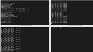

 1: is there any debug method to check the ISP occupancy and usage?
 2: We use a 5-channel 2m camera (1920*1200*raw12). It is found that the frame rate is less than 30fps, and 4 channels are normal. Our calculation bandwidth is sufficient. Experts are required to give explanations. Thank you.

    The occupancy rate of viss is between 46% and 60%. The best frame rate is not 30fps
  • hi:

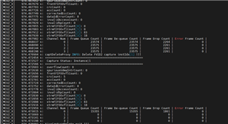

    It may be normal to re initialize capture. What is the reason for this

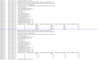

    But there are lot frame drops for both the CSI instances. This typically comes when next module in the chains is not running realtime or not returning buffers in time.. So can you please share the complete performance stats log to understand which module is not running in realtime?
    You could also try increasing the number of buffers between CSIRX and VISS and see if it makes difference.

  • HI:
    I found that after opening the 5-channel video stream, the occupancy of viss will decrease. In addition to viss, what other parameters need to be related
    If you are using multi-camera example, it uses LDC and MSC also in the chain. LDC is used for distortion correction and MSC for creating mosaic from 5 frames..
    This is why i wanted to check performance states, can you please press 'p' when the usecase is running and share the log?

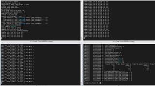

  • HI
    I checked the DDR status, viss status, and MCU task status. There was no exception, and when I started channel 5. The occupancy ratio has decreased. Is there anything else you need to pay attention to? Where is the bottleneck?
    It would be bit difficult to figure out from the above image, there are just three nodes and nodes are running in realtime, all of them are taking less than 33ms.
    Could you please add below in your code and get us the complete graph performance? You could refer to any of existing vision apps application to integrate it.

    From the first image that you have shared, most likely, capture is running fine, but graph is running at slower fps, because some other component in the graph is slowed, so capture is dropping frames..
    What all other components are running in the graph? Can we get performance of these components?
    Brijesh
