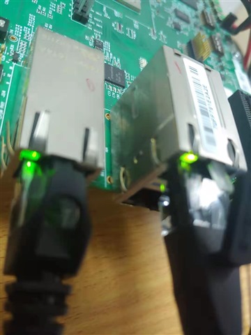

 I follow the step in SDK document with SK EVM and GP EVM, and use eth0 and eth1 port like this
When I ping the port, there’s nothing happen, even if I use the two PRU Ethernet ports, there still nothing happen
In addition, after prp0 is configured, I see that prp0 is not in up state, so I need to ifconfig PRP0 up. Is this normal?

  • Actually, if I use ifconfig to config the port, it can ping, but flow the step in SDK to use ip link, it cannot ping
  • Hello Ethan,
    I got my boards set up this weekend, but I did not have time to run any tests yet.
    Note that the two stacked PHY connection points are connected to the PRU Ethernet ports by default. So you are trying to run HSR/PRP with one CPSW port, and one PRU Ethernet port. I do not know if that configuration is supported. I also need to verify that PRU Ethernet supports HSR/PRP running on Linux (and not just CPSW Ethernet).
    Do you see the same behavior if you run tests again using both PRU Ethernet ports?
    Once you have followed the steps in that SDK document page, I would expect that you could ping the IP address of the other board. I do not expect that you need to change the netmask from the default settings.

  • Hello Ethan,
    First off, looks like I was incorrect. The two ports that you indicated in your picture are both configured to be CPSW ports in the test I ran with SDK 8.1 on the AM64x EVM board.
    Secondly, the instructions as-is also do not work for me at https://software-dl.ti.com/processor-sdk-linux/esd/AM64X/08_01_00_39/exports/docs/linux/Foundational_Components/Kernel/Kernel_Drivers/Network/HSR_PRP.html . For some reason the system does not seem to recognize the IP address? I will file a ticket to get a developer to comment.
    However, I could get the steps to work by using "ifconfig" instead of "ip" for some of the commands. My steps are below.
