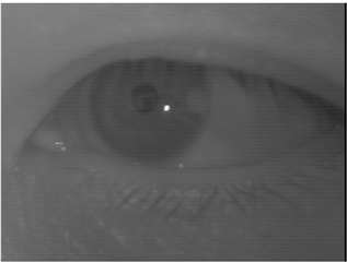

Hi Champs
Could you give me a tuning guide regarding CAMERA VPFE?

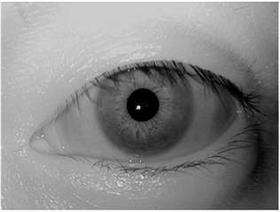

The customer found a step phenomenon of the captured image on AM4372, and is looking for a related method. Please give us your opinion on whether we can handle it on VPFE.
The engineer of the customer thinks that the VPFE driver of the EVM has strong sharpness in the default setting, so please review if there is a way to change various settings.
The figure of bottom left (figure 1) is captued from AM4372 EVM, But The image of bottom right (figure 2)  is their expected result.
Thank you.
Jack
Figure 1.
Figure 2.

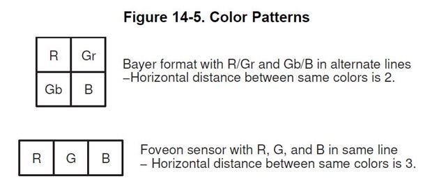

    BTW. Can you also please let us know how to set Foveon Sensor mode of RAW Data Mode-CFA type referred below.?
    Jack
  • Hi Jack,
    I reviewed the TRM, the driver source, and the VPFE peripheral registers, and I don't see anything that can be configured for Foveon sensors. Looking at TRM section 14.3.2.1.3 Black Level Compensation it looks like that the sensor type only really matters in the context of the black level compensation feature. So it looks like if the black level compensation feature is turned off, there's nothing that needs to be configured on the VPFE peripheral and the associated Kernel driver to accommodate different color patterns of the different sensor types.
    Regards, Andreas

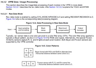

    When I checked TRM of AM437x, I found RAW_BAYER format in AM437x is RGB format as expected.
    So, I think this blurred image comes from video format mismatch, and I think they should use YCbCr digital format and modify it for Y800 format.
    If you have any idea and guide for Y800 format, it would be very helpful to guide customer to resolve this issue and please help on this.

  • Hi

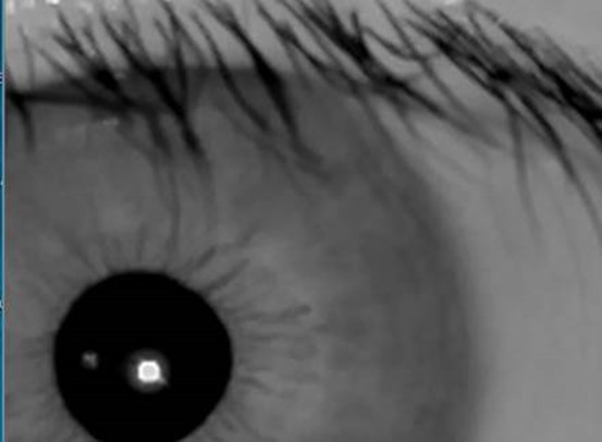

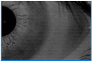

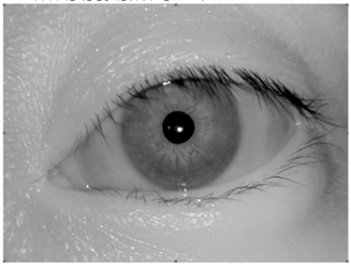

    There is a more detailed picture of the image difference.
    1. Their desired image (Target with same image sensor, PC7080D)
    2. Current Result image (with same image sensor, PC7080D)
    There seems to be no difference in the original size, but when you zoom in VPFE captured, the horizontal line is clear and it is not suitable for Iris Recognition.
    Accordingly, I checked the field setting and deinterlace setting, and it is set to NOFIELD and there is no deinterlace setting, but the image appears like that.
    We would like to ask you to review if it can be changed that way depending on the setting.
    In addition,
    They changed all the settings (hpol, bpol) related to Sync polarity and changed the pclk in various ways, but there was no difference.
    And I tried to force the A-law via vpfe driver to enable it, but there is no difference.
    When I set the interlace related setting to V4L2_FIELD_INTERLACED, the image is not displayed.
    We will inform you of Black Clamp and Black Compensation after additional testing.
    For your information, the following horizontal lines are clearly visible when the camera module has completely blocked the light.
    Please take care of this issue with higher prioroity as this customer is facing the due date of Mass production delivery.

  • Dears
    The issue is, in conclusion, guided by the sensor manufacturer
    It turned out to be a power supply problem, so it was solved by modifying the H/W patch and PMIC settings.
    As in the attached mail, They set up the ISP test pattern and captured it to make sure that it was a problem with the VPFE capture group, and it came out clean.
