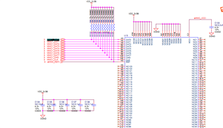

AM3354: [issue feedback] after changing the emmc, there has some problem, need your support !
Part Number: AM3354
Other Parts Discussed in Thread: TPS65910
after change the emmc , there has some issue, need your great support !
the detail information as below:
>>> the change point:
        AS IS :  AM3354 + [emmc] (samsung 4GB KLM4G1YE4C ) , there is no problem.
        TO BE:  AM3354 + [emmc] (Toshiba 8GB THGBMJG6C1LBAIL) , has some issue as following
>>> issue description:
U-Boot# mmc list
OMAP SD/MMC: 0 (SD)
OMAP SD/MMC: 1

has the following issue when select the EMMC:
U-Boot# mmc dev 1
mmc_read_data: timedout waiting for status!
omap_hsmmc_send_cmd: timedout waiting on cmd inhibit to clear
and this is the error info from the kernel:

[ 2.047833] tps65910 0-0024: No interrupt support, no core IRQ
[ 2.055231] tps65910 0-0024: Error in configuring external control EN1
[ 2.062069] mmc0: error -110 whilst initialising MMC card
[ 2.067592] tps65910 0-0024: Failed to initialise ext control config
[ 2.075943] vdds_dpr: failed to enable
[ 2.083223] tps65910 0-0024: failed to register tps65910-pmic regulator
[ 2.090052] tps65910-pmic: probe of tps65910-pmic failed with error -121

>>> hardware interface:
