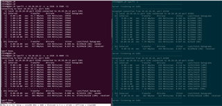

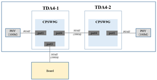

We use sdk8.2 with QNX+RTOS environment, the connection of ethernet is as following:
We do network performence test using iperf3. The RGMII(100M) interface with TCP/UDP performence test OK.
The two SGMII(1000M) interfaces with TCP performence test is also OK. But UDP performence test result is NOK, it just up to 350M bandwidth with no package lost.If higher, there will get more lost package.
Could you give some advice ? Thanks.

  • Before we discuss specifics about this scenario, let's consider some facts:
    1. Forwarding will take place based on the ALE table entries: either learned ones (see point #2) or static added (i.e. via app/driver).
    2. Learning takes places on ingress. Source MAC address is learned.
    3. Learned address will be aged out from ALE table.
    4. Unknown unicast packets are flooded to all enabled ports (except to the ingress port).
    =1=
    In the TCP test, traffic flows in both directions. So TDA4-1 and TDA4-2 both learn about the other being at the respective port 4. Here traffic is not flooded, but only forwarded to port 4. Since there is constant handshaking between the two TDA4s, ALE learned entry is never aged out.
    =2=
    In the UDP test, traffic is unidirectional, let's say from TDA4-1 to TDA4-2. So, TDA4-2 properly learned that TDA4-1 is at port 4. But TDA4-1 doesn't know TDA4-2 address (since there is no traffic from TDA4-2 to TDA4-1), so TDA4-1 is treating the UDP traffic as unknown unicast, forwarding to all enabled ports.
    In TDA4-1, traffic ingresses to the switch via host port, and here is the catch: host port traffic is never dropped, so the slower ports 1 & 3 (which are running 100Mbps links) is creating back pressure which ends up hurting the iperf UDP throughput. Again, this happens because ports 1 & 3 are also receiving the UDP traffic due to unicast flooding.
    You could try the following:
    • Adding a static unicast entry in TDA4-2 with TDA4-1 MAC address using this IOCTL.
    • Have application maintains some logic (keep alive/acks) to ensure that learned address is no longer flushed out.
    One the second point, you can try (in the background while iperf test is running) pinging TDA4-2 from any of the devices connected to TDA4-1, so that there is traffic from TDA4-1 back to TDA4-2 and learning can take place.
