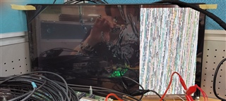

Hi Experts,
I am working on a DRA829 custome board with DS90UB941AS connecting to UB948 with 1080x1920 panel.
By following up the bring-up guide, I am stucked in “DSI_DTYPE Reported Wrongly”.
DSI_DTYPE retuens 0x0.
This is the configuration of DSI (4 lane): SDK 8.01

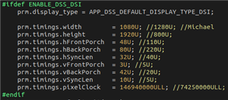

1. vision_apps/apps/basic_demos/app_tirtos/common/app_init.c
2. vision_apps/utils/dss/src/app_dss_defaults.c
3. ti/drv/dss/src/drv/dctrl/dss_dctrlDsi.c
4. vision_apps/platform/j721e/rtos/common/app_cfg_mcu2_0.h

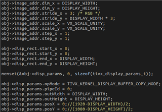

5. vision_apps/apps/dl_demos/app_tidl/app_common.h
6. vision_apps/apps/dl_demos/app_tidl/main.c

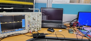

8. Output:

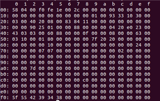

[MCU2_0]     18.074743 s: 0x2c Success!!
[MCU2_0]     18.079738 s: 0x2c Success!!
[MCU2_0]     18.612735 s: I2c finish
[MCU2_0]     18.612940 s: [Michael] 0x16, 0x0 0x2c
[MCU2_0]     18.613139 s: [Michael] 0x16, 0x1 0x0

FPS is 3.96. It seems something there, BUT panel is BLACK.
Please help me debug this situation.

  • I measured dsi txclk today which is around 440~443 Mhz, but nothing on the data lane.
  • Hi Jay Sun,
    You could get data only when you run some example. So please check the data lanes only after running the example.
    Are you running above example in the debug mode? Because i see the performance of most nodes in non-realtime. Fileio is taking 61.8ms, DRAW taking 60ms and display 250ms.. This could be reason why graph performance is very less.
    Do you have single camera or multi-camera example brought up on your board? Then can you try running one of the camera application?

    The dsi txclk and data lane were measured while running run_app_tidl.sh.

  • I am trying to light up the vertical screen with  (Horizontal)1080 x (Vertical)1920 at 60fps.
        (1080+48+80+32)x(1920+3+42+10)x60 = 1240x1975x60 = 146.94Mhz
    (0xE << 5 | 0xE) is for lane band between 870 to 950 Mbps, am I right?
  • Sorry i mixed it up. Yes, the resolution, pixel clock and lane speed seems to be correct.

  • The data lane signal looks fine in the resolution of 1280x800.
    Atfer that, I modified dphyTxFbDiv to 0x16F in the 1080x1920 setting for the rest of parameters.
    The panel started displaying test pattern automatically after booting up even without enabling PATGEN, and I could not disable it.
    #It is dsi data lane signal on the oscilloscope.
    #while running multi-camera example
    That's good to know.
    Not sure from where these color pattern is coming. Is there something enabled in the Serializer or Deserializer? Can you please check config of both?
    But from DSI point of view, it looks like you are getting some valid data output. Can you please try running some demo to check the output?
    Brijesh

    Brijesh
  • This test pattern is coming from the panel controller if it detects mismatched signals like clock or data type.
    Now, it has something on the panel, but I am not able to do more fine tune on the pixel clock since there is pretty limited range for DSI_PCLK_DIV.
    # ub941 reg dump, writing 0x19 to 0x1f and returning 0x9a=154 Mhz for pclk.
    # ub948 reg dump, writing 0x14 to 0x1b and returning 0x93=147 Mhz for pclk. It`s pretty close to target pclk (146.94 Mhz).
    Thanks.
  • It's a video timing isuue. Everything works fine now.
    By the way, I refer to the other thread that said to use ceiling value for FbDiv calculation, but it only works with flooring value.
