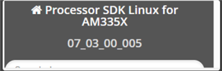

HI:
I use BSP version 07.00, but RTS automatic switchover is required. Then I add the following attribute (rts-gpios) in the device tree. Although it can be switched automatically, it is found that it cannot wake up after the sleep . If this attribute is removed,add rts-gpio, I can wake up from sleep. The following is my device tree configuration:

    RS485 support is not validated and supported by the Processor SDK, since we don't have any EVM supports RS485 function. So I won't be able to tell why rts-gpios breaks on suspend/resume.
    I checked the kernel source, GPIO based RTS support was added since kernel v5.3 which is not very long before the SDK 7.0 kernel (v5.4) which you use, so it is possible the feature is not fully supported yet. Can you try the latest AM335x SDK v8.2 to see if the issue still exist?
