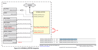

I configured the sysconfig to have the GPIO1_43 input with rising edge trig type on the R5FSS0_1 core INSTEAD of the R5FSS0_1 core.

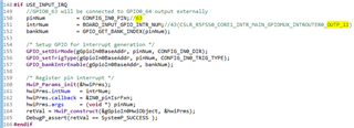

I copied the interrupt initialization from the "gpio_input_interrupt_am64x-evm_r5fss0-0_nortos_ti-arm-clang" example, changing only the core number:
CSLR_R5FSS0_CORE1_INTR_MAIN_GPIOMUX_INTROUTER0_OUTP_8
Instead of
CSLR_R5FSS0_CORE0_INTR_MAIN_GPIOMUX_INTROUTER0_OUTP_8.

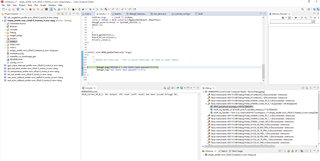

I see that a call to sciclient is done in the "gpio_input_interrupt_am64x-evm_r5fss0-0_nortos_ti-arm-clang" example. Do I have to use this init too?
Both cases (sciclient init or not) the interrupt is never triggered.
I don't fully understand how to initialize a simple GPIO interrupt, do you have some information for me?
Why using the INTROUTER0_OUTP_8 and not the INTROUTER0_OUTP_0 for example?

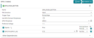

  • Dear Bastien,
    Please follow the below procedure to configure GPIO_Interrupt on C13 Pin for R5FSS0_1 Core.
    1. Add GPIO peripheral in system.config as per attached image.
    2. Change GPIO initializations as per below code .

  • Dear ,
    I followed the same above procedure in free_rtos project for RFSS0 core and software is running successfully ..
    Please try to made changes as per above procedure .
    Please find the attached image FYI..

  • Hi ,
    Yes I am Running on RFSS0_1 core .
    Please try to do CPU reset and power on Reset before Load binaries on RFSS0_1.

    I don't get the interrupt connection from the driver to the core interrupt number.
    Reading the TRM and datasheet i understand those information:
    INTRTR_IN to INTROUTER0_OUTP is not OK so (/16)?
    The interrupt map is the same for R5FSS0_0 and R5FSS0_1 so why do we have to change the OUTP value?
    I don't find the information about the inside of the GPIO_MUX_INTRTR0 to link INTRTR_IN to INTROUTER0_OUTP.
    Sincerely,
    Bastien

    Case 1 : You have asked one question why not BOARD_BUTTON_GPIO_INTR_NUM values as CSLR_R5FSS0_CORE0_INTR_MAIN_GPIOMUX_INTROUTER0_OUTP_0.?
    Please check the sciclient_defaultBoardcfg_rm.c at 187th Line and find it in below path
    ...mcu_plus_sdk_am64x_08_02_00_31\source\drivers\sciclient\sciclient_default_boardcfg\am64x_am243x.
    There is resource filed and it is starting from 8th source. So, we have to keep BOARD_BUTTON_GPIO_INTR_NUM value from CSLR_R5FSS0_CORE0_INTR_MAIN_GPIOMUX_INTROUTER0_OUTP_8 not CSLR_R5FSS0_CORE1_INTR_MAIN_GPIOMUX_INTROUTER0_OUTP_0.
    Case 2 : GPIO Interrupt configuration for R5FSS0_1 core .
    Please check the sciclient_defaultBoardcfg_rm.c at 185th Line and this field has allocated 2 Resources for CORE_0 and So, this macro should be start from CSLR_R5FSS0_CORE0_INTR_MAIN_GPIOMUX_INTROUTER0_OUTP_10 for R5FSS0_1  . (OUTP_8 and OUTP_9 allocated for R5FSS0_0 core.
    So, we have to keep BOARD_BUTTON_GPIO_INTR_NUM value as CSLR_R5FSS0_CORE1_INTR_MAIN_GPIOMUX_INTROUTER0_OUTP_11 .
    Please try to modify changes as above and we are trying to solve those configurations in next release.
    Thanks your input..

    I confirm the use of OUTP_11 instead of OUTP_8 is working. I understand now how the routing is done thank you.

    Please follow the below procedure for Interrupt configuration of GPIO0_63 .
    1. Please do the system config as per the below configurations.
    2. Include board.c file in your workspace.
    3. Please do below changes in Sciclient_gpioIrqSet() and Sciclient_gpioIrqRelease( ) functions in board.c file

    4. Please do below changes in empty.c file
    #define CSL_GPIO0_BASE (0x600000UL)
    uint32_t pinNum = BOARD_BUTTON_GPIO_INTR_NUM ;
    uint32_t intrNum = 63;
    5. Compile code and Load binaries on your destination core.

    Here are the parts i modified
    sysconfig
    board.c
    empty.c
    Everything is alright. I also tried to switch the interrupt to OUTP_10 and it's ok too thanks.
