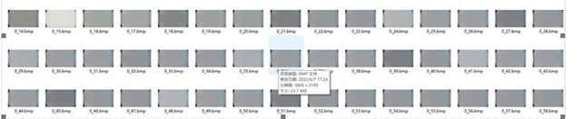

In the DNP 1000lux environment(In fact, it will also appear in any test scenarios), we continuously capture a certain number of pictures .  we found that the brightness of the pictures fluctuated back and forth, as shown in the figure below. We want to know what causes this problem and How can we optimize and solve it. Thank you!

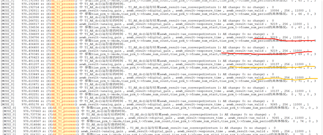

    The above figure is AE output for exposure and  agian、dgain  for the 1000lux environment.
    From the log, we can see that the gain value  is not  stable ;the log is the AE output. thanks!

  • Please enable AE_DEBUG and catch related log, and I will check for the stability of H3A.
  • AEDEBUG_1000Lux_LOG.txt
    The attachment is AE  Debug  log, thanks!
  • The values of R/G/B change regularly from your log. So I think something happened in the sensor side, please check this with sensor vendor. Thanks!

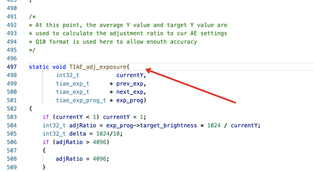

  • carry and gang, we modify the  TIAE_adj_exposure paramter, and the brightness of picture is stable . thank you for your support !
  • Which parameters did you modify, and could you share the solution, thanks!
  • we Increase the delta value, and add the  adjRatio point.
