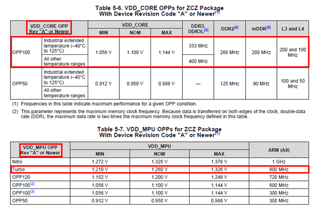

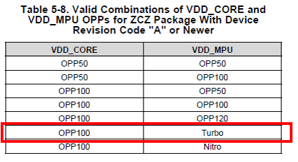

According to the specification of AM3352,
the voltage supply requirements of VDD_CORE and VDD_MPU are as follows
Freqiency
VDD_CORE (V)
VDD_MPU (V)
AM3352BZCZ60
600 MHz
1.1
1.1
AM3352BZCZ80
800 MHz
1.1
1.26
If put an 800MHz AM3352 in a 600MHz power supply, will the 800MHz be down-converted to 600MHz?
Or will the system work abnormally??
