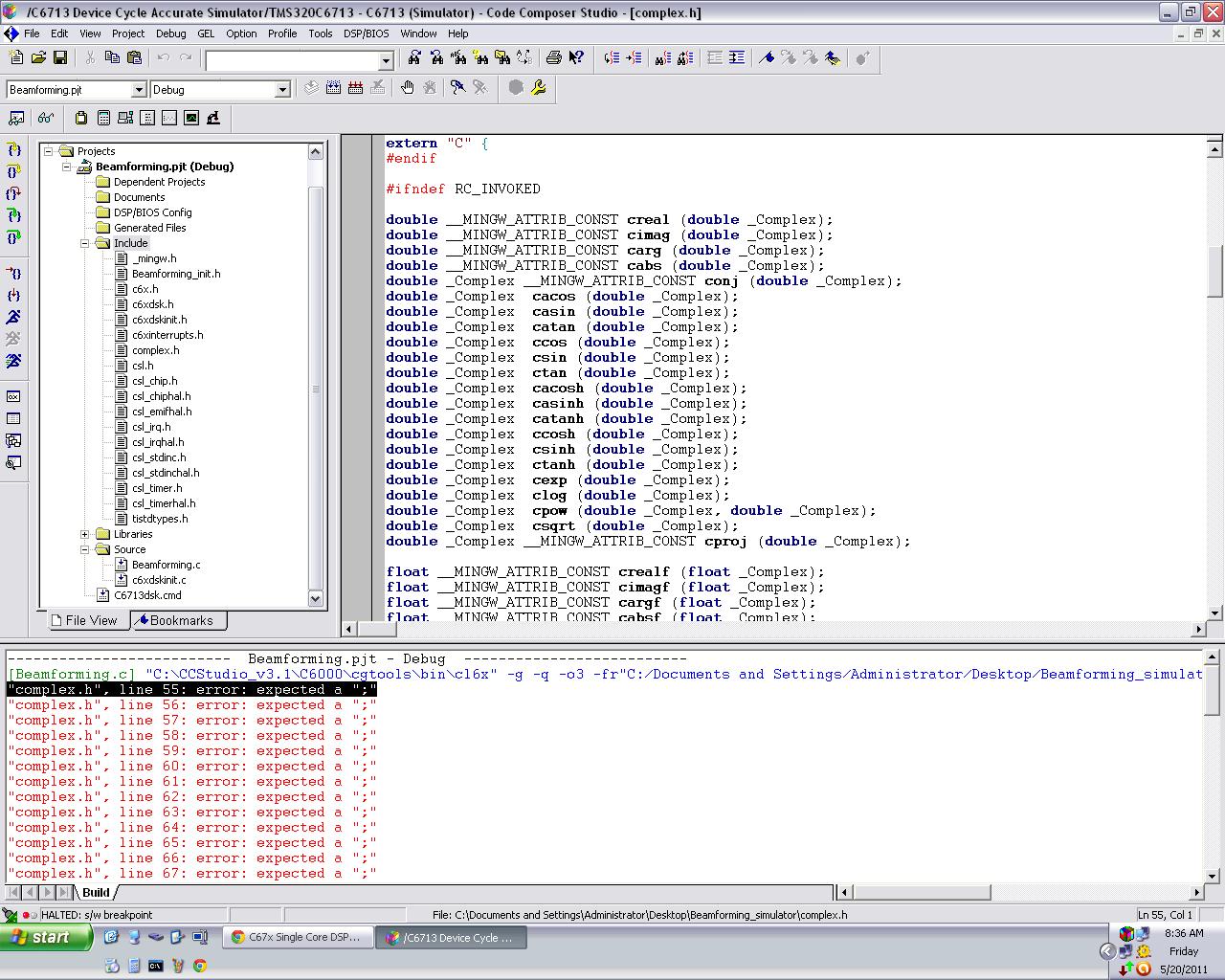

I want do some complex (real + imaginary) computations. such as complex number addition, multiplication, complex exponential etc.
I am using c6713 and have added complex header files in my project.
But it is giving errors.
Can you please help me rectify that ?

  • its giving errors in beamforming.c
    when i add complex.h it gives error. when i remove header file. error is gone.

  • HI
    These are errors
    --------------------------  Beamforming.pjt - Debug  --------------------------
    [Beamforming.c] "C:\CCStudio_v3.1\C6000\cgtools\bin\cl6x" -g -q -o3 -fr"C:/Documents and Settings/Administrator/Desktop/Beamforming_simulator/Debug" -d"CHIP_6713" -mr1 -mv6710 --mem_model:data=far -@"Debug.lkf" "Beamforming.c"

    "complex.h", line 78: error: declaration is incompatible with "double _Complex" (declared at line 55)
    "complex.h", line 78: error: expected a ";"

  • Amir,
    Thank you for providing the error text; I think I see the problem now.  It looks like this header file is written to use complex value functionality added in the C99 version of the C language.  Unfortunately, the TI compiler does not support C99.  It also does not support the complex value extensions found in GCC.  This means that processing complex numbers in DSP applications usually means managing interleaved data buffers, as in:
    void cplx_mpy(float *x1, float *x2, float *y, int N)
        float x1_real, x1_imag, x2_real, x2_imag;
        int i;
        for (i = 0; i < N; i++)
            // get real, imaginary values
            x1_real = x1[2 * i];
            x1_imag = x1[2 * i + 1];
            x2_real = x2[2 * i];
            x2_imag = x2[2 * i + 1];
            // compute real output term
            y[2 * i] = (x1_real * x2_real) - (x1_imag * x2_imag);
            // compute imaginary output term
            y[2 * i + 1] = (x1_real * x2_imag) + (x1_imag * x2_real);
    Hope this helps.
