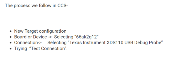

We have designed our custom board of 66ak2g12 EVM. We were trying to debug using XDS110 DEBUG PROBE but the target is not able connect and we are getting error on test connection.
The process we follow in CCS-
  • New Target configuration
  • Board or Device ->  Selecting “66ak2g12”
  • Connection->     Selecting “Texas Instrument XDS110 USB Debug Probe”
  • Trying  “Test Connection”.
But it throws an error and not successfully connecting to board. The error log I’m attaching as a text file.
Please guide us to resolve the issue.

  • Hi Paul,
    I have mentioned the process of configuration at the beginning of the thread, also which debugger we are using. Please let us know is there any additional step is required or any mistake we are doing in the process.
    I'm attaching  the snap of the process of configuration.
    Note: After following this process we are getting some error  that I have attached at the beginning of the thread.
    Asif

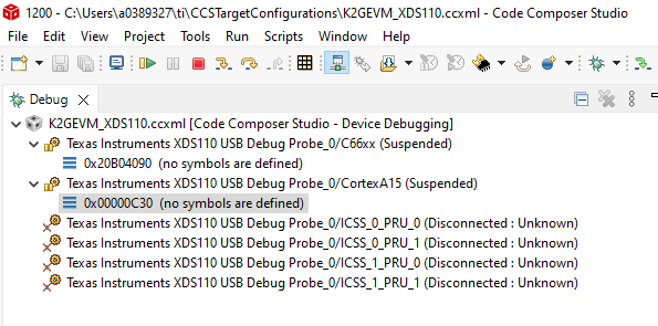

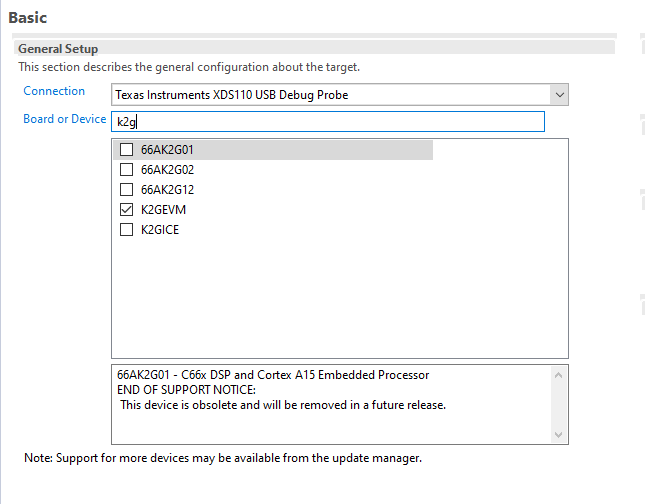

  • I was able to connect to my K2G EVM using an external XDS110 debug probe when using J19 on the EVM:
    My config:
    I can connect to both DSP and ARM without issue:
    Note that when I try using the JTAG header on J7, while the connectivity test passes I get connection errors when trying to connect to either core with CCS. I'm not sure what is the reason for this. I recommend using J19 for now.
    ki
