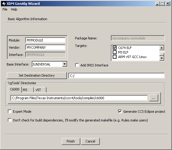

I am trying to create my own algorithm in CCS 4.
I have the default CCS installation which installs XDAIS for you. I use "Tools->XDAIS->GenAlg" to run the wizard. I enter the following settings:
When I click on "Finish" it comes up with this error:
"An error while creating package mycompany.mymodule:
TypeError: Cannot read property "cgTools" from null".
Anyone have any tips - I'd be grateful to hear them? Slightly surprised that this wizard doesn't just work out of the box.

  • What is the XDCtools version being used by Code Composer? You can find out by selecting Windows->Preferences->CCS->RTSC. It will be shown under "RTSC support" in the right pane.
    Also, can you verify that the directory "Program Files\Texas Instruments\<XDCtools version>\packages\ti\targets\elf" is present?
    Joe

  • This is a bug. An incident report has been filed:  SDOCM-- IncidentReport SDOCM00081266
    The resolution will be available in the next XDAIS release. For immediate resolution, copy the two files in the attachment to your GenAlg install directory:
    "Program Files\Texas Instruments\<xdais install dir>\packages\ti\xdais\wizards\genalg"
    Joe
