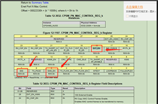

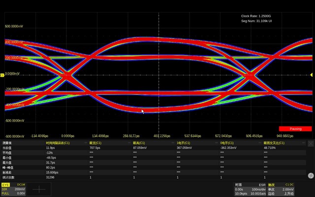

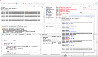

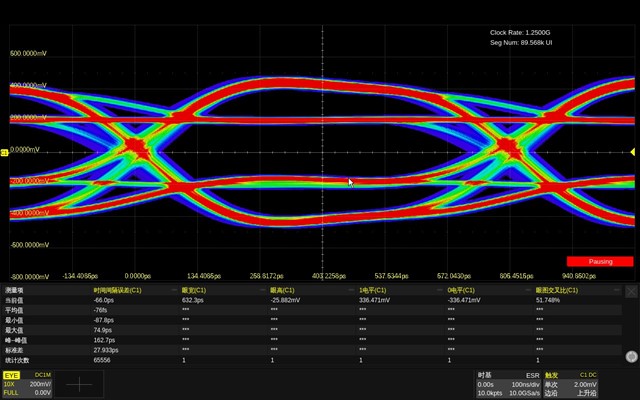

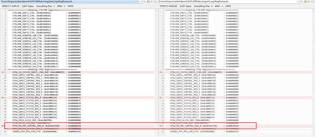

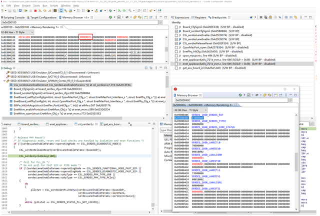

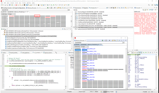

Some times , we got eth0 mount fail, then we checked mcu2_0 log, we can see program hangs down below:
Then we checked the sgmii register status ,we got  0x00000030
After that, we checked PHY link status, and it is link up!
TDA4 isn't update sgmii link status in the initialization phase, please help us to check how dose it happend.
Thanks a lot.

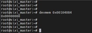

    1.I mean the link-status register in the phy's register is link up,but in CPSW_MDIO registers I got link down.
    2.We use SDK7.2.
    3.The frequency is so high, like up to 80% in some specific TDA4, but other TDA4 dosen't  appear.
    The link down in CPSW_MDIO registers would indicate that your phy isn't getting detected. Can you see if the register is "ALIVE". It is indicated in CPSW_MDIO_ALIVE_REG (0x0C000F08)

    2. We use CPSW9G as the driver, if the ETHFW is finish configuration, on the linux side will mount an eth0 network card like this
      but we just get this  when the sgmii link status gose wrong.
    3.We use CPSW9G port0 for the SGMII link.I can send you c file of serdes configuration,do you have any tools for dump?
    4. We use MARVELL 88Q5072, anfd it is etched on the board.
    5. Dump register MDIO ALIVE: 0x98000FFF

    I dump sgmii register and send Email to Sikai, he will send it to you.

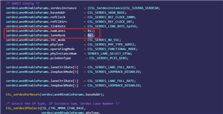

        serdesLane0EnableParams.baseAddr          = CSL_SERDES_16G0_BASE;
        serdesLane0EnableParams.refClock          = CSL_SERDES_REF_CLOCK_100M;
        serdesLane0EnableParams.refClkSrc         = CSL_SERDES_REF_CLOCK_INT;
        serdesLane0EnableParams.linkRate          = CSL_SERDES_LINK_RATE_1p25G;
        serdesLane0EnableParams.numLanes          = 0x2;
        serdesLane0EnableParams.laneMask          = 0x3;
        serdesLane0EnableParams.SSC_mode          = CSL_SERDES_NO_SSC;
        serdesLane0EnableParams.phyType           = CSL_SERDES_PHY_TYPE_SGMII;
        serdesLane0EnableParams.operatingMode     = CSL_SERDES_FUNCTIONAL_MODE;
        serdesLane0EnableParams.phyInstanceNum    = SERDES_LANE_SELECT_CPSW;
        serdesLane0EnableParams.pcieGenType        = CSL_SERDES_PCIE_GEN3;
        serdesLane0EnableParams.laneCtrlRate[0]   = CSL_SERDES_LANE_FULL_RATE;
        serdesLane0EnableParams.loopbackMode[0]   = CSL_SERDES_LOOPBACK_DISABLED;
        serdesLane0EnableParams.laneCtrlRate[1]   = CSL_SERDES_LANE_FULL_RATE;
        serdesLane0EnableParams.loopbackMode[1]   = CSL_SERDES_LOOPBACK_DISABLED;

        And here is the dump of normal state and abnormal state:
    log_dir_ok.tar.gzlog_dir_bad.tar.gz

  • Dear Linda and Tanmay,
         1. Do we have any registers to reset the sgmii(serdes) and phy?
             Write 0C000110h bit1 to 1 then 0 to trigger reset.
         2. We have tried to write 0C000104h bit0 which "Software reset occurs immediately. This bit reads as a zero". However it will keep become 1. So we doubt whether the SGMII is still alive or not.
         3. How could we know the status of SGMII?
             Read 0C000114h bit0 to see link status.
         4. What is the mechanism of link?
         5. Could we write any register to force it to link?
         6. Need to explain why choose force link instead of auto-negotiation.
         7. The only difference is they use GP before and HS now.
         8. Try to reset PHY(hardware rst pin) or serdes(05000404/40C). Wait for test results.

  • Notes from 8/10 review by TI team:
    1. On failed boards, CPSW_PN_MAC_CONTROL_REG_k register was set to 0x0. This can be either caused by 1). CpswMacPort_configSgmii() called before CpswMacPort_enableSgmiiPort(), for case:
          else if (sgmiiMode == ENET_MAC_SGMIIMODE_SGMII_FORCEDLINK),
    Note that only for this case SGMII link status register are checked and waited, other cases, the function only enables auto-negotiation.
    or, 2). the CPSW_PN_MAC_CONTROL_REG_k register was corrupted after the driver set it.
    2. SERDES registers patched:
    /* PMA_CMN_REFCLK_INT_MODE */
    if(refClk >= CSL_SERDES_REF_CLOCK_100M) /* 100MHz and greater reference clock */
    CSL_FINSR(*(volatile uint32_t *)(uintptr_t)(&sierra_sds_reg->WIZ_CONFIG.SERDES_TOP_CTRL),29,28,0x1);
    // add modified 3 line directly change register
    CSL_FINSR(*(volatile uint32_t *)(uintptr_t)(&sierra_sds_reg->WIZ_CONFIG.SERDES_TOP_CTRL),31,30,0x0);
    CSL_FINSR(*(volatile uint32_t *)(uintptr_t)(&sierra_sds_reg->WIZ_CONFIG.LANECTRL0),25,24,0x0);
    CSL_FINSR(*(volatile uint32_t *)(uintptr_t)(&sierra_sds_reg->WIZ_CONFIG.LANALIGN0),5,0,0x0);
    look good.
    Next debug steps:
    1. Tanmay to confirm if case 1) happened for FORCEDLINK case, with ethfw team.
    2. Sikai to request UART log of MCU2_0 from a good board to compare.
    3. Sikai to work with customer to add UART output at the end of function CpswMacPort_setSgmiiInterface(); this is the function where the PN_MAC_CONTROL registers was set. Since we did not see the error msg in the end of this function "MAC %u: Failed to set SGMII interface: %d\n", we suspect this function was never called in time. please verify.
    Jian

  • Dear Experts,
         The phenomenon is:
         1. We use CCS to stop at the entry of CpswMacPort_configSgmii()
             From the code logic we can see at this moment we have not config MAC:
             And when we stop at the entry we have not configure SGMII:
         2. When in abnormal state:
             a) 0C000114 = 00000030
            b)  0C000120 = 00000000
            c) 0C022330 = 00040000
        3.  When work in abnormal state:
             a) 0C000114 = 00000031
             b) 0C000120 = 00004001
             c) 0C022330 = 000400A0
    Here are some questions:
        1. Is this initialization step right?(Config Sgmii then MAC and do CpswMacPort_configSgmii() earlier than CpswMacPort_enableSgmiiPort() )
        2. TDA4 will be powered on first then Switch. Will this have any effect?
        3. Who will set Link Partner status?
        4.
  • 4.Who will set this two bits once we have set EXT_EN, software or hardware? If it is handled by hardware why it will show different values sometimes?
  • Dear Experts,
         We tried to reset serdes in Board_CfgSgmii( )  from EnetBoard_setPhyConfigSgmii( ).
         We use CCS to debug step by step and find the register will change when we complete CSL_serdesLaneEnable( ):
         1. 0x0C000114 will change, within 5 times it can change to 0x00000031
         2. 0x05000488 will change. When in abnoraml state, 0x05000488 will be all 0.
        So we step into CSL_serdesLaneEnable( ) to see when we set the 0x05000488 register:
        It shows in CSL_serdesReleaseReset
        So here is our question:
        1. Why in normal board reset PHY once is enough while in abnormal board it has possibility that link status will not be updated?
        2. Any ideas to further locate the problem?
    BR
    Sikai
  • Hi, Tanmay and Sikai,
    We got a bad board register dump and a good board register dump are down below, please help us to check it.
  • Hi, engineers of TI,
    As you talked in meeting, we try to this:
    1.disable PCIE in linux
    2.programed just use LANE0, and don't used LANE1 We can see the register value, the PCIE is disable:
    This is where we change in the serdes code,
    but still, we get 0x38 in link status register: 0x0c000114, but we get a correct value in register 0x050004cc.
    So it seems like it did't work if we disable PCIE
    Linda Wang
  •     Here are the eye graph from both end of link of RX.

  • Dear Experts,
         After we set a default configuration of the RST pin of Marvell's switch. We have run the pressure test on several boards and it works fine.
         However here are several new questions happened during the process:
         1. We need to set the GPIO AH21 low when powering on and set it high after APP starts up. So we add this logic in SBL, however when we try to pull the GPIO down in MCU2_0, it fails. They also tried to pull it down in A72, it can work. Linda will post their change here.
         2.  During the process they also found the PHY_RESET function did not run during the initialization.
         3.  During the process they find one board will have high possiblity to reproduce the similiar issue of this link:https://e2e.ti.com/support/processors-group/processors/f/processors-forum/1080303/tda4vm-cpsw9g-mdio-not-alive
    BR
    Sikai
  • Dear Experts,
         After pressure tests, the error still reproduces in 1178 times. Here are some ponits hope to get an explanation:
         1.  When we pull down GPIO in SBL and pull up after system boot up, it takes over 1000 times to reproduce. However, if we pull down and pull up GPIO both in the very beginning of MCU2_0, it only takes dozens of times to reproduce.
         So why the time sequence will have such huge influence?
         2. They are using MAC-MAC to connect serdes and switch. From my point of view, once power on with correct configuration then the link status should be up right? So in this case, it has possibilty that the link status will not update, is it caused by mis-configuration of serdes?
    BR
    Sikai
  • Dear Experts,
         Thanks for Field team's onsite support, we have successfully combine the two workaround together. And after 3000+ times tests, only 1/3650 possibility to boot within 50ms which is the longest time.
         Customer will verify it in real cars later.
