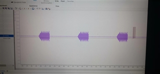

    I have monitored one of the 10ms cycle messages,  the cycle time will keeps 10ms for 60 -70 seconds, and then the cycle time will changed like a wave:
    Could you please tell me what can I do to solve it?
    Can you help me understand the image you attached?

  • Hi Chengwu.Tang
    Can you also help me understand this image you attached?
    Karan
  • Hi Karan,
    1.The ordinate of the above picture is the interval between two receptions of the same message, and the abscissa is the time axis.
    2.The problem now is that 10ms is very stable in 160s~190s, but 9.3ms~10.7ms appears in 190s~200s fluctuations,and there are regular fluctuations When there is always a message received on the can bus (cycle 50ms)
    3.When no message is received on the can bus,  it will be a straight line, and there will be no fluctuation
    BR
    Lei
  • Hi Lei
    Seems like at the intervals of 100ms where there are (2 + 9 + 5) messages Transmitted and 7 messages received, in that case there is a burst of high CPU load. Can you check if you still see the inconsistency in the receive task if there are no transmitted messages?
    If disabling the Tx improves the situation then there is a problem that the TX and RX together are not able to trigger at exact time due to CPU load. This can be improved however.
    Karan

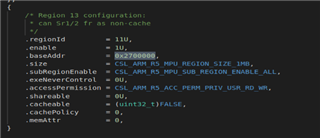

    I don't understand the third item the “device memory instead of strongly ordered”, This means that when we enable the cache(according to the first suggestion), we need to configure the cachePolicy  as CSL_ARM_R5_CACHE_POLICY_NON_CACHEABLE and memAttr as CSL_ARM_R5_MEM_ATTR_STRONGLY_NON_CACHED?
    For example the following code?, Can you give me a sample code for configuring mpu?
    BR,
    Lei
  • Hi Lei
    You can refer to the R5F's TRM from ARM. Some information is here - https://developer.arm.com/documentation/ddi0406/c/Application-Level-Architecture/Application-Level-Memory-Model/Memory-types-and-attributes-and-the-memory-order-model/Device-and-Strongly-ordered-memory#:~:text=The%20only%20architecturally%2Drequired%20difference,component%20accessed%20by%20the%20write
    +        //Region 9 configuration: covers MCU MCAN MSG RAM
    +        .regionId         = 9U,
    +        .enable           = 1U,
    +        .baseAddr         = 0x40500000,
    +        .size             = CSL_ARM_R5_MPU_REGION_SIZE_512KB,
    +        .subRegionEnable  = CSL_ARM_R5_MPU_SUB_REGION_ENABLE_ALL,
    +        .exeNeverControl  = 0U,
    +        .accessPermission = CSL_ARM_R5_ACC_PERM_PRIV_USR_RD_WR,
    +        .shareable        = 0U,
    +        .cacheable        = (uint32_t)FALSE,
    +        .cachePolicy      = 0U,
    +        .memAttr          = 0U,
    You can add a section like this in the MPU.
    Karan

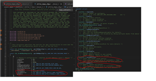

  • Hi Karan,
    Could you give me a suggestion configuration about the MPU that enable the cache and set the memory type to device memory.
    For example, what values do these three (.cacheable / .cachePolicy / .memAttr ) need to be configured to?
    + .shareable = 0U,
    + .memAttr = 0U,
    XXXXXXXXXXXXXXXXXXXXXXXXXXXXXXXXXXXXXXXXXXXXXXXXXX
    Karan

  • Hi Karan,
    We try configure mpu MCAN7/9/11 MSGMEM_RAM cacheable,memAttr in device memory ,as follows,the problem is still there:
    Preliminary judgment is related to can bus arbitration:  Could you have suggestions to optimize the periodic message bus arbitration problem?
    BR,
