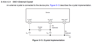

Hi experts,
Q1:Is it correct to understand that "VSSA_OSC0" is connected to GND inside the SoC since it is marked "TYPE: GND" on the datasheet?
Q2:If an external crystal is used, is it correct to understand that "VSSA_OSC0" should be connected to GND, although it is not specified in the datasheet?
My customer confirmed that the SoC works without any problem even if "VSSA_OSC0" is left unconnected to GND on the board side. (xo_osc0 and vssa_osc0 are connected.) They are not experiencing any problems, but they would like to know the correct status of the SoC internal connections for their design.
