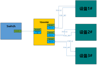

2) Below is a rough diagram of the TDA4 PCIe connection, could you help check is it OK?
3) TDA4 Serdes0 pairs to Switch, TDA4 uses QSGMII, Switch uses 5GBASE-R. Are the two protocols compatible?
    [Jian] I checked SERDES muxing scheme, all PCIe looks good. Ethernet may have an issue - QSGMII is not compatible with 5GBASE-R, thought they both support 5Gbps. To interface with the switch, you will need USXGMII running at 5Gbps, but that is not enabled by software in TDA4 presently.
