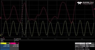

    Re-test ENET5 port with internal tx delay: with internal tx delay the edges of clock are aligned with center of data (RGMII clock skew). At QNX where the communication works the RGMII is w.o. clock skew (see below)
    linux - internal delay: RGMII5_TXC, RGMII5_TD0
    =3=
    Capture TXD0 / TXCLK signals: using a 200MHz scope, so the signals are a bit BW-compomised, but the phase relations are recognizable. No differences between linux and QNX observed.
    linux: RGMII5_TXC, RGMII5_TD0
    QNX: RGMII5_TXC, RGMII5_TD0
