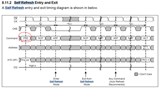

From mDDR spec, there should be a Precharge command before self-refresh command, We captured signal, did not find Precharge command, only enter self-refresh command.
DDR2 spec doesn't need precharge command before entering self-refresh command. The DDR control behave same for DDR2 and mDDR.

As with Winbond mDDR has problem on exit self refresh, and it need precharge command as below
Is there any special command to send out precharge command with enter self refresh command?

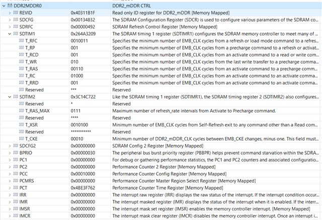

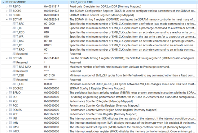

  • Tony, I'm not sure why this isn't happening for mDDR.  Can you ensure all timing in SDTIMR1 and SDTIMR2 are correct especially tRP, tXP, tXSNR, tXSRD, tRTP.  Also ensure PASR=0.
     A precharge is issued before all refresh commands.  Does the Winbond device consider the prechange from a previous refresh command?  Maybe the controller doesn't issue a precharge before the self-refresh because a precharge was already issued with the previous refresh command.

    I was using gel file initialized ddr controller:
    DDR2:  C:\ti\ccsv6\ccs_base\emulation\boards\lcdkc6748\gel\C6748.gel
    mDDR: C:\ti\ccsv6\ccs_base\emulation\boards\evmc6748\gel\C6748.gel
  • I'm not sure why you would see this behavior.  If it is behaving like a DDR2, maybe something is wrong with the initialization sequence, and the controller is actually initialized as a DDR2 inadvertently.  Are all of the init steps properly executed?  Maybe try a second init sequence?  Are you seeing functional errors with the memory?
