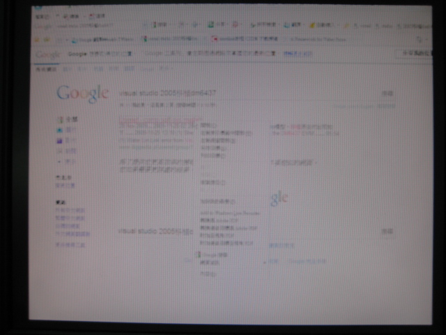

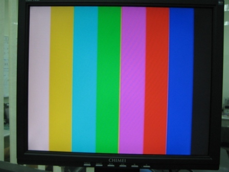

  • can you pl provide us snapshots of passing and failing case?
  • Dear :

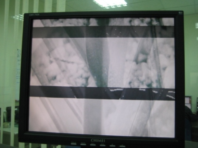

    Let me explain it more detail, the video signal which fed into S-video input on EVM6437 is from video card that plug-in AGP slot on PC, after running test program of video lookback, the output video is fed to another monitor and show as below.
    However, when we change the jumper SW7 on EVM6437 and switch the video channel from S-video to CVBS input on EVM6437, we use a camera to output a picture and feed it to the CVBS intput on EVM6437, running the same program, it will show nothing on the monitor. We trace the memory in DDR2 (CCDC->SDR_ADDR = 0x84000000), it show as below

  • Dear Nagabhushana:
    (1) We use the sample code "video_loopback" provided from install cd EVMDM6437_V2, and use use CCS V3.3 to compile and rebuild the environment. Please see attached file for reference. It is just a simple code(without DSP/BIOS) to demo the lookback function from S-video/CVBS input to S-video/CVBS output. The question is it operates normally in S-video channel but abnormal in CVBS channel.
    7140.video_loopback.rar
    (2) The new update information is after we reconfigure the evmdm6437.gel, then we can see something output on monitor, but it seems abnormal and  just gray scale and no color.
    The original picture is as below~
    The abnormal phenomenon is as below~
    Alan

    • In failing scenario, you are connecting output of camera to CVBS input on the board. What is the standard camera is outputting(NTSC/PAL)? Based on input standard you need to program tvp514x/vpfe(In your case, you need 2 change/configure your application accordingly).
    • Problem can be with display or capture. You need to figure out what is working fine(capture or display). Then, it will be easier make problem to fix.

    (2)The possible reason we though is from VPFE, we use another test program "video_colorbars" which used to test VPBE function to test EVM6437, it is OK and show as below~
    Alan

    We though the possible reason could be the control procedure of VPFE after some experiments. For different video input, the setting and control method should be adjusted.
    Alan
