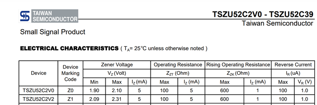

Hi zhao qing,
Could you please elaborate absolute max rating value mentioned above.
Kalyan.
Hi zhao qing,
Thank you for clarifying the requirements.
The VPP supply range is min:1.71 -- Nominal:1.8 and -- Max:1.89 V.
Give the recommended operating range, i would recommend selecting a zener diode that has a minimum zener voltage > 1.89V. Please refer below table as an example for selection of zener.
