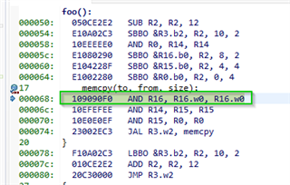

The bug in short is this:
Function foo has 3 arguments, which get passed into memcpy. The third argument is in r16. Although function foo's third argument is uint16_t, and memcpy's third argument is uint32_t, the r16 is just passed through without cleaning the upper word. This leads to having trash value in the register/argument whenever memcpy is executing. In this example it leads to a copying size of 0xFFFF000A, instead of it being 0xA . Obviously this will cause an exception and halt the code execution.

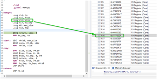

The bug explained:
First we make sure that some known value gets written into register r16, by calling a function which does this.
Now we observe that r16 has the value of 0xFFFF000A, right before we call memcpy.
The disassembly does not show us any sign that r16 is being modified in our foo function, from which the memcpy will be called.
Memcpy is called, r16 has a value, which is totally wrong

If optimization is set to -Ooff we can observe that before calling memcpy, r16 is being clipped, after which it has the proper value of 0xA
Further investigation shows the following:
If the function which calls memcpy uses its 4th argument to pass on to memcpy's third argument, then the clipping from uint32_t to uint16_t is performed with the following assembly command:
AND R16.w0, R17.w0, R17.w0
As can be observed in compiler explorer
It also should be noted, that gcc for pru does not have this defect.
Furthermore, if I would call a C implementation of memcpy, then the r16 clipping would be performed:
