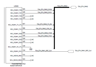

I have a few questions about MAC2MAC Feature for TDA4 and would like your help.
We want to connect CPSW2G(MCU Domain) with CPSW9G(Main Domain) by RMII form. Below is our circuit design for MAC2MAC. Could you help confirm if this RMII form is feasible for TDA4  MAC2MAC? I think it is no problem for MAC to PHY, but I'm confused about MAC to MAC. Actually there is a guide for MAC2MAC, but it only shows RGMII and SGMII solution without RMII solution.
   MAC to MAC.pdf
