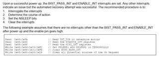

  • Chaitanya,
    Lets continue discussions on this thread, and see how we can recreate this or get closer to the problem.
    It will be important if you can attempt to provide some more information around the points captured below.
    1. Can you see any logs from any of the UART instances available before the crash occurs that might indicate a failure signature?
    2. Have you attempted to connect via debugger to any of the cores and if yes, we can try to come up with a list of things to do.
    3. I"m assuming that you have more than one board for the GP and HS variant, do you see this consistently across multiple boards - just want to rule out any board specific marginality here.
    4. Is there any watchdog setup on your system?
    5. PDN sensitivity - has the PDN gone through a review?
    6. Is there any software that invokes TISCI APIs to reset the main domain - has such code been added in your system?
    7. Another set of ideas - may be we should make a list of all the various software entities that are running in the various cores and try to isolate by removing the one's that we don't need for this usecase.
    Karthik

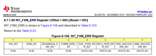

  • Hi Karthik,
    Please find attached here is the I2C sniffer data. we have monitored the I2C signals after bootup and during crash also.
    another one we have also same time dump PMIC I2C registers after bootup and after crash PMIC dumps.
    Can you please let me know further debugging steps
    configured 0x4D reg to 0x80 in PMIC-A
    	After Power ON Before running applications

    	After Removing SOC_SAFETY_ERROR
    Got same wakup i2c_dump for Power ON and reboot time
    write to 0x54 nak
    write to 0x50 nak
    write to 0x51 nak
    write to 0x50 nak
    write to 0x51 nak
    write to 0x48 ack data: 0x0E
    read to 0x48 ack data: 0x37
    write to 0x48 ack data: 0x05
    read to 0x48 ack data: 0x2B
    write to 0x48 ack data: 0x0E 0x3A
    write to 0x50 nak
    write to 0x51 nak
    write to 0x50 nak
    write to 0x51 nak
    write to 0x51 nak
    write to 0x52 nak
    write to 0x54 nak
    write to 0x50 nak
    write to 0x51 nak
    write to 0x50 nak
    write to 0x51 nak
    write to 0x51 nak
    write to 0x52 nak
    write to 0x54 nak
    write to 0x54 nak
    Chaitanya

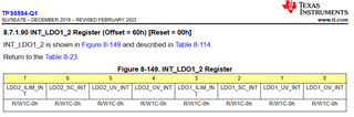

    (1) After power on, PMICB LDO1 and LDO2 UV errors are indicated.  Additionally, the SOC_PWR_ERR_INT is also set (0x69=0x08).
    (2) After reboot, PMICA BUCK3 has a UV error and there is a corresponding MCU_PWR_ERR_INT.
    (3) After reboot, PMICB still has UV errors on LDO1 and LDO2.
    (4) Both PMICA and PMICB are pre-release NVM revisions (beta).  I will need to do some more investigating to understand what limitations if any are in these NVMs.
    [Chaitanya]: Yes we see that however board is booting without any issues also could you please confirm (0x69=0x08) is because of LDO1 and LDO2 UV detection?

    0x60 = 0x22
    https://www.ti.com/lit/ds/symlink/tps6594-q1.pdf#page=258
    0x69 = 0x08

    Q3) When we power on the board we see the startup interrupts are generated by PMIC-A, However we are not able to clear them over I2C. Could you please guide us the sequence to do the startup interrupts.
    Before you clear the interrupts you must set the nsleep bits to the active mode.  This should not however prevent you from clearing the interrupts (write '1' to clear).  If you clear the interrupts without setting the nsleep bits then you will go to the retention state.
    https://www.ti.com/lit/ug/slvucf3/slvucf3.pdf#page=42

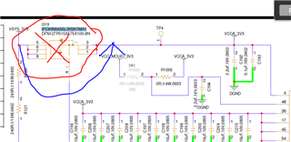

    1. We have remove the PMIC-A input protection MOSFET Q19 and shorted Drain to source as shown in below and thereafter we have powered on our board and run the applications .
    2. with this hardware modification we have not observed any reboot our board.

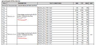

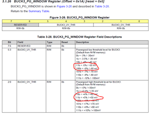

    Q1) As Per PMIC register description the BUCK3_PG_WINDOW register is described as 5%/-50mv or 5% /+50mv for UV and OV detections. should we need consider 5% of feedback voltage or 50mV from feedback voltage
    Example:
    we have connected 3.3V  on PMIC-A buck3 feedback, if we consider 5% UV condition the feedback voltage is = 3.3*0.005= 0.165= 3.3-0165= 3.135V
    in another way if we consider only 50mv from the feedback voltage the UV condition shall be 3.3-0.050 = 3.25V
    could you please clarify on the above point.
    Q2) we see the PMIC-A NVM revision is 02 however as per ''Optimized TPS65941213-Q1 and TPS65941111-Q1 PMIC
    User Guide for JacintoTm 7 J721E, PDN-0C user guide document'' the PMIC buck 3 PG window register threshold is configured as 10%/100mv. could you please clarify how these thresholds are defined .
    Chaitanya
  • Q1) As Per PMIC register description the BUCK3_PG_WINDOW register is described as 5%/-50mv or 5% /+50mv for UV and OV detections. should we need consider 5% of feedback voltage or 50mV from feedback voltage
    Please use 5% for 3.3V output voltage.  The selection, % vs mV, is a function of the output voltage.  Refer to section 7.10 of the datasheet, https://www.ti.com/lit/ds/symlink/tps6594-q1.pdf#page=31.
    The thresholds are defined based upon the requirements for the DRA829, which is +/-5%.  The output of the load switch, which is monitored by FB_B3, is unique because input is the VCCA and the VCCA OV/UV is +/-10%.

  • EXPERIMENT2:
    If you bypass the protection FET, then also be sure to connect VSYS_SENSE to gnd and leave OVPGDRV floating.  The VSYS_SENSE is used for the charge-pump to drive OVPGDRV and is part of the fail short test.  The test conducts a brief interruption of the charge pump to verify that the VCCA drops and the FET has not failed short.
